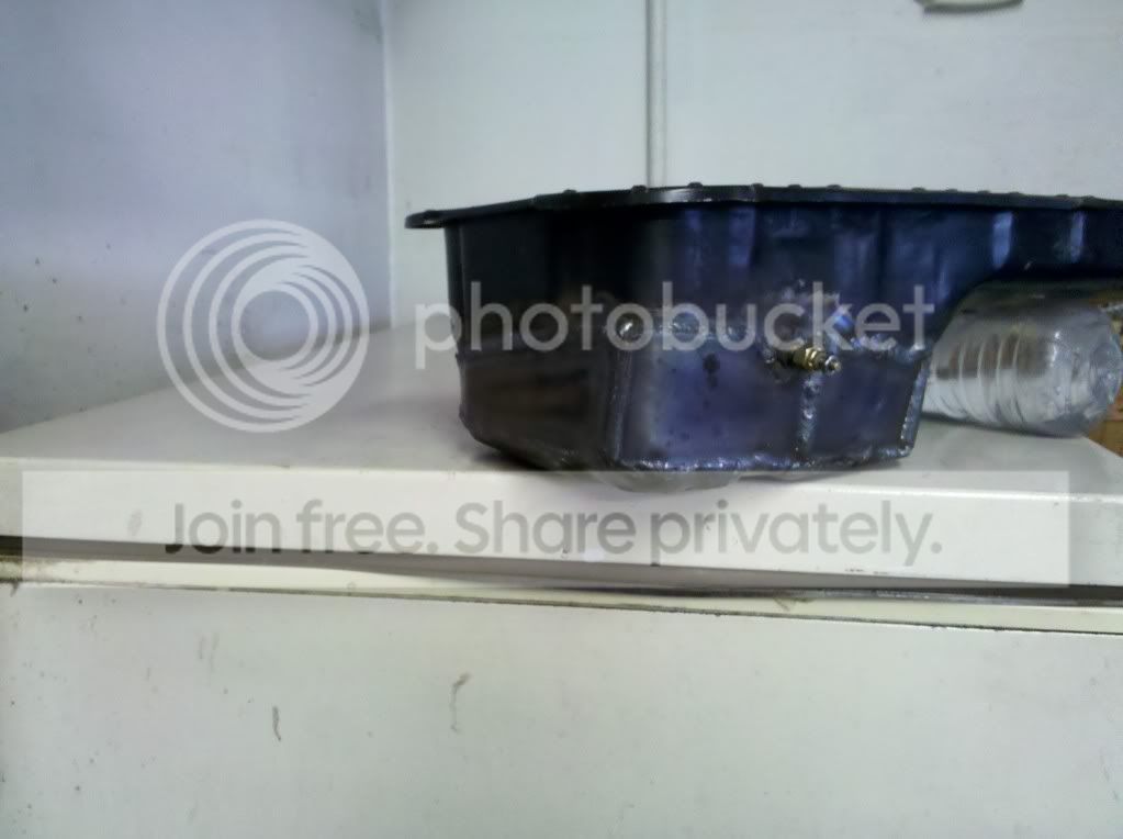

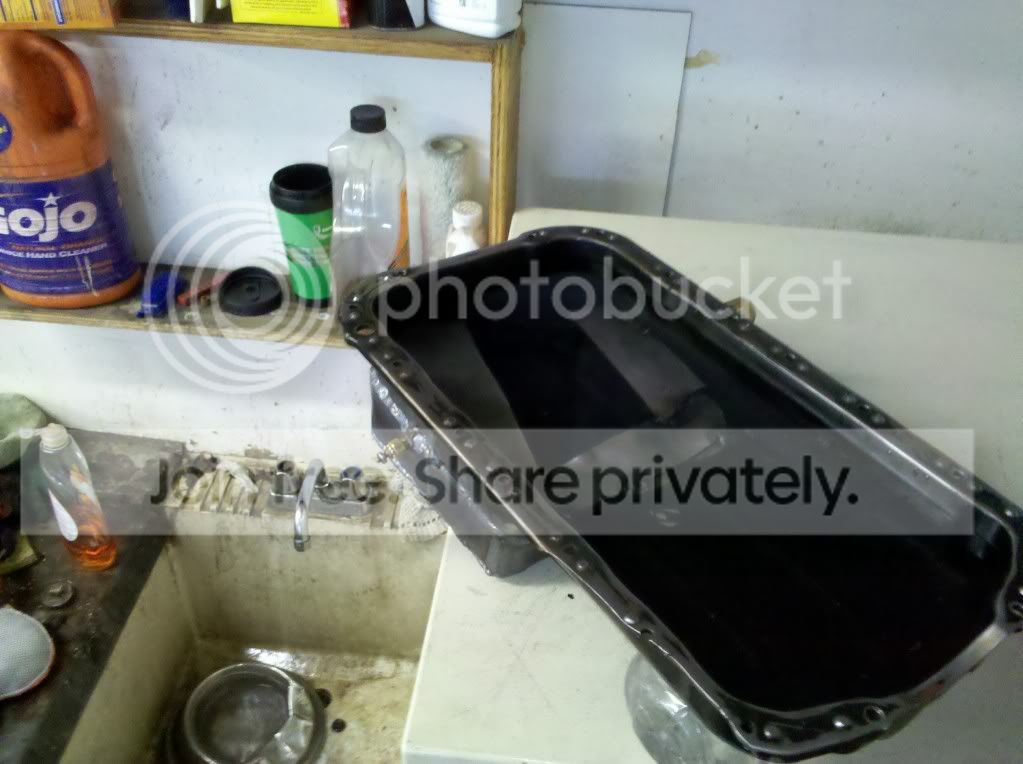

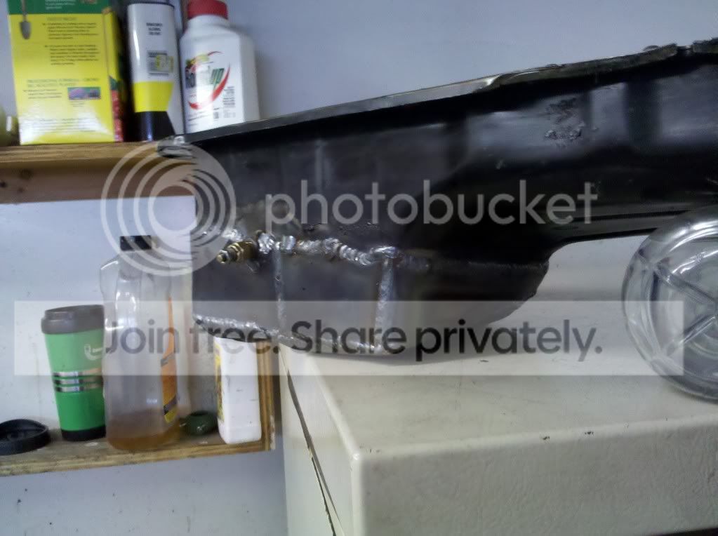

i cut my oil pan apart and redesigned something is should have redesigned years ago.
the F and H pans are not flat on the bottom, because the engines are angled rear-wards in accords/preludes. this makes the back of the pan higher, with it sloping downwards towards the front of the engine when mated to D/B trannies.
its been baffled, but it still lost some pressure on hoosiers in really long lefthand sweepers.
i chopped the sump off, dropped it down, re-did pickup, etc.
going to instruct for chin motorsports this weekend at autobahn, and i'll find out if it works then.
filled with water checking for leaks...
what a pain in the neck. i used slightly thicker material, and it should make the pan pretty fricken strong too. for some reason this lighting makes it look terrible. it actually looks pretty good. the drain is on the front if your curious (moved it there years ago.)

Nice work RED, was gonna ask about the drain too actually! haha.. I went with a moroso, hope the baffles help out, I admire your desire to build it your own way though and specific to your own set-up, let us know how it works out..
