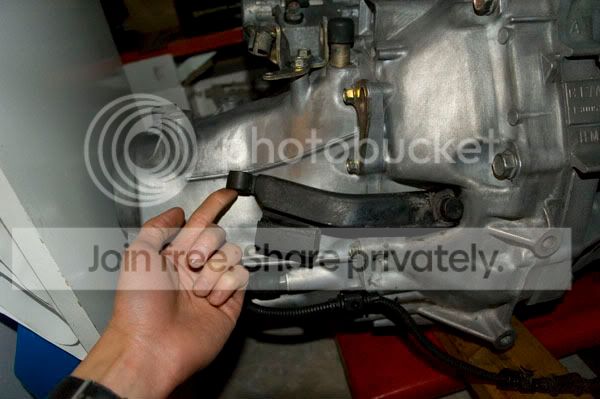

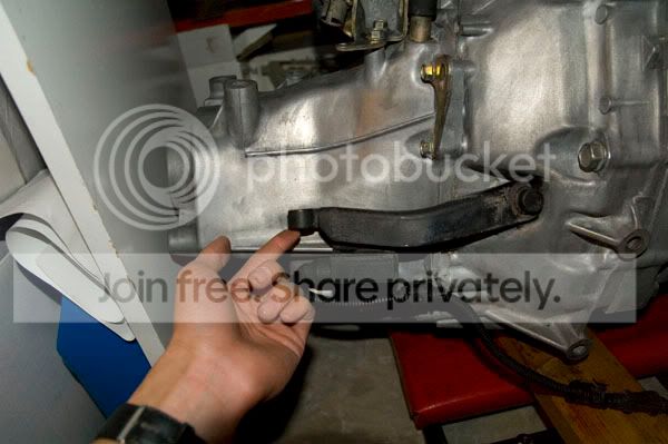

For all you B-heads out there with cable transmissions...Does this much free play in the cable-clutch arm look correct to you?
At rest:
At contact with pressure plate:

THE one i have right now on the floor S1 rest point is the same...
Now the B16A with tranny attached to motor looks the same on my end at rest point and clutch contact...

So everything looks good? Thanks a lot Moe

actually with the clucth cable attatched this pictures repersents the rest point on my tranny
so yours is alright I would guess

Yea it looks good eric, u can take up the 'slack' when adjusting the clutch cable.

Seems about right. That really isn't adjustable anyway. I think with the cable attached it will be fine.

Thanks a lot for the responses about the cable-arm guys, just double checking to make sure nothing was off haha

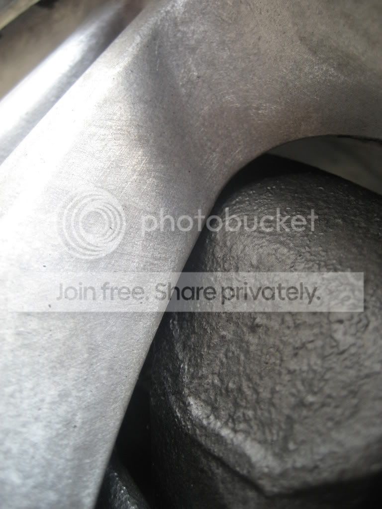

How much clearance is needed between calipers and wheel spokes when taking into account things like expansion under high heat situations? Or is it not as big of a deal as I'm thinking it will be?
This is about all I have right now:

take a angle grinder and get to work
I had to do the same thing on my calipers to get my CF-48 from rubbing in the inside

Fastbrakes recommends no less than 2mm, which is what I have with the Spoon clappers. Get some 5mm H&R spacers
