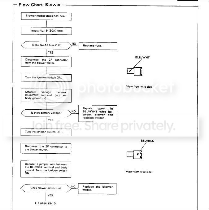

Does anyone know why my heat would not be working? I checked the fuses and no dice. Nothing happens if I put the heat on level 1,2,3, or 4. Is that part controlled electrically or is it cable actuated?

<TABLE WIDTH="90%" CELLSPACING=0 CELLPADDING=0 ALIGN=CENTER><TR><TD>Quote, originally posted by thenick &raquo;</TD></TR><TR><TD CLASS="quote">Does anyone know why my heat would not be working? I checked the fuses and no dice. Nothing happens if I put the heat on level 1,2,3, or 4. Is that part controlled electrically or is it cable actuated?</TD></TR></TABLE>,
Try checking to see if your blower motor is still good or not.

Thermo's fine though. It's just there's no air coming out when I switch it on to 1,2,3, or 4. It's like it's not even turning on.
<TABLE WIDTH="90%" CELLSPACING=0 CELLPADDING=0 ALIGN=CENTER><TR><TD>Quote, originally posted by cbp_crx &raquo;</TD></TR><TR><TD CLASS="quote">,
Try checking to see if your blower motor is still good or not.</TD></TR></TABLE>
How do I do that?

Thenick, unhook to plug on the blower motor, and use a test light on the plug that hooks to the one on the motor, to see if your getting any voltage or not. If you are, chances are that the motor is bad, it is a common thing for them to go bad, I have replaced a few on my rex, and a few on other crxs as well. Also, you could test by using a known good one, if you could find someone with one out of their car. They are around 40 bucks to replace in my area.

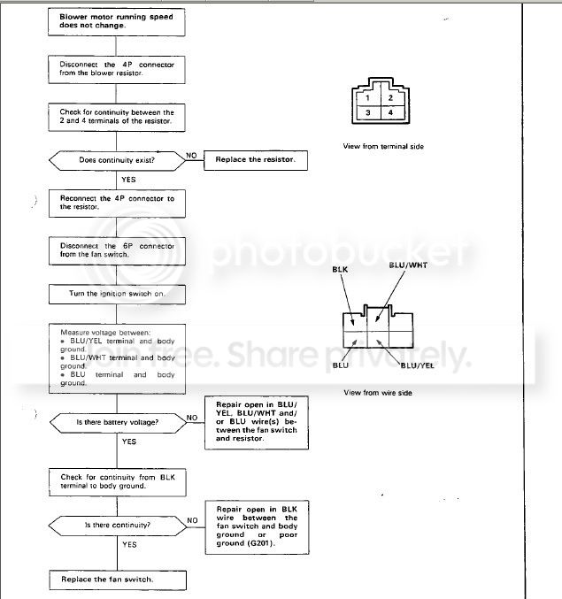

There is a resistor in your fan motor that can **** the bed, sometimes when they are going the fan only works on high (kinda like me )

Yeah, I was gonna mention the resistor. I've heard of those going bad quite a bit.
