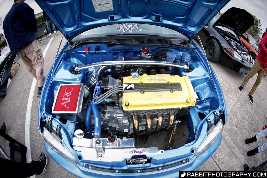

Little Update
Old Jan 5, 2013 | 04:31 PM
  #25394
WhiteSlips's Avatar
Posts: 6,808
From: OKC,OK
Looks great! What cam gears are those?

Greygoose94's Avatar
Joined: May 2011
Posts: 664
From: WASHINGTON
thanks, they are AEM Tru-Time cam gears
Old Jan 5, 2013 | 06:48 PM
  #25396
speedooo's Avatar
Posts: 13,388
Likes: 8
From: Wall, NJ
That motor looks so clean!
I'm looking at a 93 si this week. I've been missing my old car a lot lately
Old Jan 5, 2013 | 07:20 PM
  #25397
Joined: May 2011
Posts: 664
From: WASHINGTON
Thanks speedoo. the valve cover needs to be cleaned up i just barely put it on yesterday.
