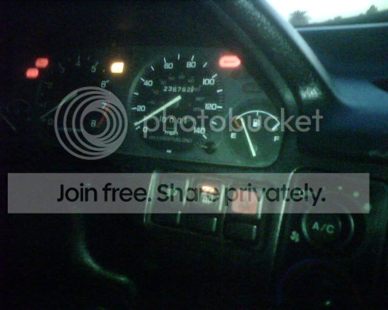

ok well i was doing the ecu code thing and i plugged in the piece of wire as i turned the key on this went on and started flashing instead of the check engine light like wtf then i took out the key and was going to start to count when it didnt do it anymore so anyone know whats up with that?

where do you plug a piece of wire, I wanna try this see if i can figure out whats wrong with my DA.

its on the passenger side by the end of the carpet.you plug in a wire or a paper clip and you turn the key on the cel will flash depending on how any flashes it gives it determines what is wrong with your car their is a list.click on that link it shows a picture but thats in a del sol or civic i think.

thanks ! I will check my ecu tomorrow with the cel test. I hate to replace everything if I can figure it out that way it would be alot easier.

...lemme give you some advice...don't even bother...even if you get it to work right the freakin stuff is so risky...i've tried messing around with OBD0...problem is, it is so off-cue that if there is more than one thing wrong you cannot get to it all at once, and sometimes it reads wrong...best idea is to figure out what is wrong by diagnostics (ears, eyes)...
If you are having fluctuations in your idle, take our advice...check your coolant level...clean your throttle body...check all vacuum lines...if that does not work then bring it to someone that knows what they are doing with OBD0 testing...
I am just speaking from experience...make sure that you do it right, and in the presence of someone that knows what they are doing...there are no fail-safes in OBD0 and it is just too risky
