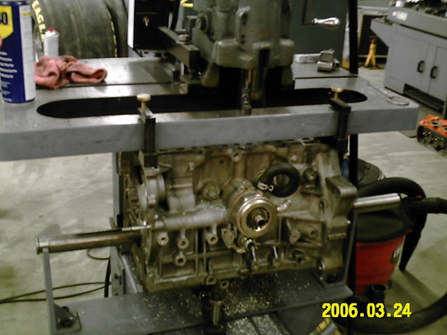

SLEEVED AND ALMOST READY TO GO!
Those's sleeves were a pain in the *** to get in. i'm just glad it was not a 5 cylinder.... no energy left lol

Something is goofy here on a few levels. Those can't be Chevy sleeves because the bore is too small PLUS Chevys are iron blocks so you don't sleeve them anyway.
Second, sleeving a block throws a million chips all over the place. There has not been a chip thrown by the machine in that pix.
Third, the top of that block was not surfaced recently. That should have been done as a final step to evening the block out.
The bar thru the main bearing saddle would never hold that block for any kind of machine work...so I know that is just for show, hehe

<TABLE WIDTH="90%" CELLSPACING=0 CELLPADDING=0 ALIGN=CENTER><TR><TD>Quote, originally posted by earl &raquo;</TD></TR><TR><TD CLASS="quote">Something is goofy here on a few levels. Those can't be Chevy sleeves because the bore is too small PLUS Chevys are iron blocks so you don't sleeve them anyway.
The bar thru the main bearing saddle would never hold that block for any kind of machine work...so I know that is just for show, hehe</TD></TR></TABLE>
look very close you can see the chips on the back side of the block and no we were not going to surface until sleeve's we installed, and your wrong about the machine it was that one that did the work boring out the fmr material. i have a video of it being done if i can get my roommates camera that took the video i can send it through email if you like.
sending parts out to be cryoed and when they get back from that i'm sending parts out to me coated. once that's done getting the block and head together. waiting to sell AEM EMS and then i'm go to get the h2b adapter.

I would definitely need a video to buy into this one.

whats with the black line on cylinder number 3?

i will emai it to you earl and cyclinder number three as some metal on it it looked like a crack when i was looking at the pics but it's not

<TABLE WIDTH="90%" CELLSPACING=0 CELLPADDING=0 ALIGN=CENTER><TR><TD>Quote, originally posted by projectTeG &raquo;</TD></TR><TR><TD CLASS="quote">whats with the black line on cylinder number 3?</TD></TR></TABLE>
Probably a guide mark for the hacksaw to cut the old sleeves out.

no i chipped them out with a sledge hammer

<TABLE WIDTH="90%" CELLSPACING=0 CELLPADDING=0 ALIGN=CENTER><TR><TD>Quote, originally posted by 92 CIVIC HATCH VX &raquo;</TD></TR><TR><TD CLASS="quote">no i chipped them out with a sledge hammer</TD></TR></TABLE>
I was being sarcastic with the comment about something as crude as a hacksaw when dealing with something as precise as engine tolerances with regards to your sleeves. I guess the sarcasm wasn't really necisary, as you guys took a BFH to it anyways. That's like trying to perform open heart surgery with a broad sword.
