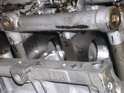

motor back from getting aline honed and will take pic before sleeving

aline hone
crank before polishing
aline hone

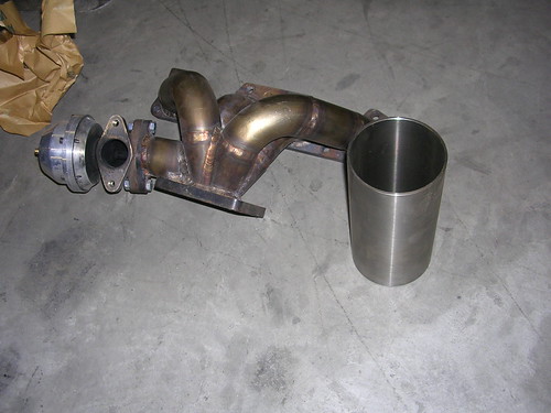

small block chevy.
also i pick up my sc61 and intercooler with fpr tomorrow. will take pics.
the way i'm sleeving the closed block h22 won't work for open decks.
i will take pics of the process.

<TABLE WIDTH="90%" CELLSPACING=0 CELLPADDING=0 ALIGN=CENTER><TR><TD>Quote, originally posted by 92 CIVIC HATCH VX &raquo;</TD></TR><TR><TD CLASS="quote">small block chevy.</TD></TR></TABLE>
You realize the smallest bore SBC's made were the 305's with a 3.786 or 96mm bore size, vs. your H22's stock 87mm bore size. An LS1 is next up at 99mm, and a standard SBC would check in at 101.5mm.
There's ambition, and then there's sheer idiodicy......
