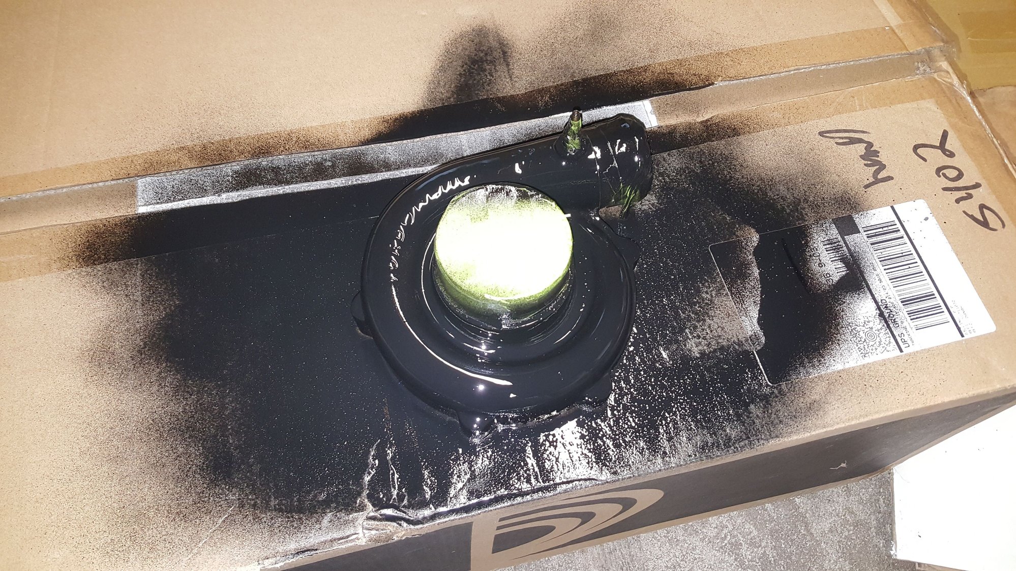

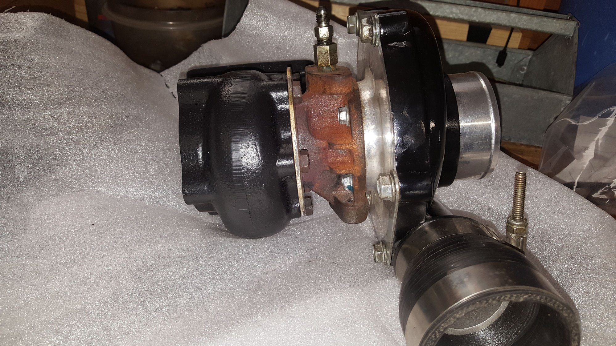

Got all the hot stuff and turbo taken off. Ready for coating
i thought this was pretty interesting. Never actually looked inside the turbine housing. How much of a pain would it be to port these.
pic of the outside of the block post
Down to the very last thing. And the nut rounds off in the worst spot ever.

I would not suggest trying to port that channel in the turbine housing

oh hell no. I didnt mean myself porting it. Shouldve been more clear. I was tthinkin bout the process of having it professionally ported. And how dragstically would it change the turbos effiency. Or if its just a situation when this should established in the cast before mold.

Porting the volute won't really help you. Only possibly the turbine inlet. I suggest making sure it's the correctly sized turbine volute to the exhaust wheel.

Yeeeeaaaa,..... doesnt sounds worth it lol.
Ceramic coated parts will be back friday.

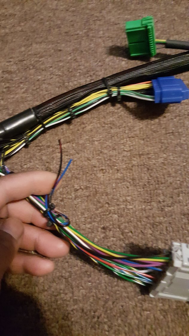

Update.....
finally got around to adjusting the steering rack. First, i tightened the bolt too much. I did two quarter turns. The car felt like manual rack with a dying power steering pump. Couple days later, i got back under and loosen it a quarter of a turn. Now the car feels responsive as it did prior. But, still kind of loose. So im thinkin, im goin to get back under there, and just bump it a smidge. Heres the steering rack adjustment bolt
i also think the high speed swaying was from a worn sway bar bracket bushing on the front. So those are goin to get replaced with energy suspension bushing and new endlinks. In the front and rear.
now on to the good stuff. Received my wireworx harness today. As advertised, its a thing of beauty. The 18 year old oem harness is starting to get brittle. Had couple wires break at the plug, behind the pin. So it was time.
its a stage 1 with integrated hondata cop harness, id1000s plugs, and extended iat plug. They actually exceeded my expectations on the iat plug. It was ran to the oem location. But they simplified it by making an plug and play harness to reach the sensor in the charge piping. So far i am highly impressed and happy with its presentation. Everything is labeled as an option. Which also makes it easier. Theres a few wire that need to be wired in. In this case i will likely cut off the one obd2b plug off of my old conversion harness. Then solder the few wires to that plug. Then just plug it rite into the oem obd2 secondary harness. Instead of cutting and splicing. I also need to repin my wire for my BBG signal. Only thing that im not fond of is down by the ecu, the wires are zip tied. Im worried in the long run, those zip ties will damage the insulation. Possibly wires. So anyway, onto the pics. I do more during the installation. And how it looks when ran.
