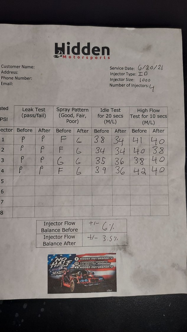

Old id1000s cleaned and flow tested( they were sticking open)

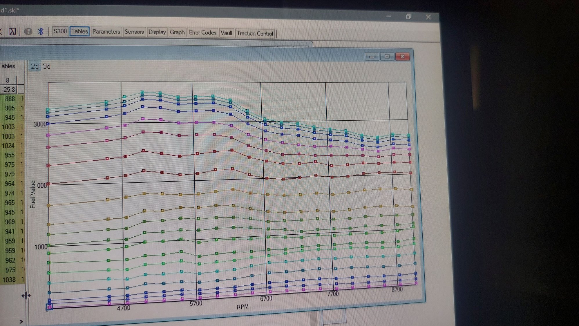

Update
Decided to take my 14 year old along with me. As ive started having him helping me do some things. Since hes getting more interested in cars. The session was a good day overall. After we got the injectors in, a leak developed at the FPR 90° adapter oring. Got that switched out and no more pressing matters other than the tires spinning so much. He had so much issues in trying to dial everything in due to how fast and early on it was ramping in. Aswell as the knurling being completely worn down on the rollers.

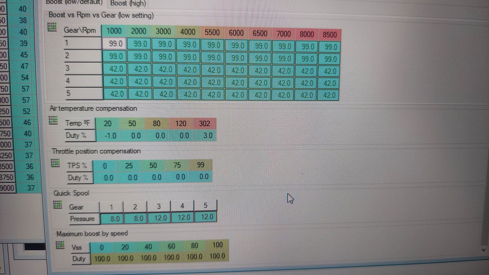

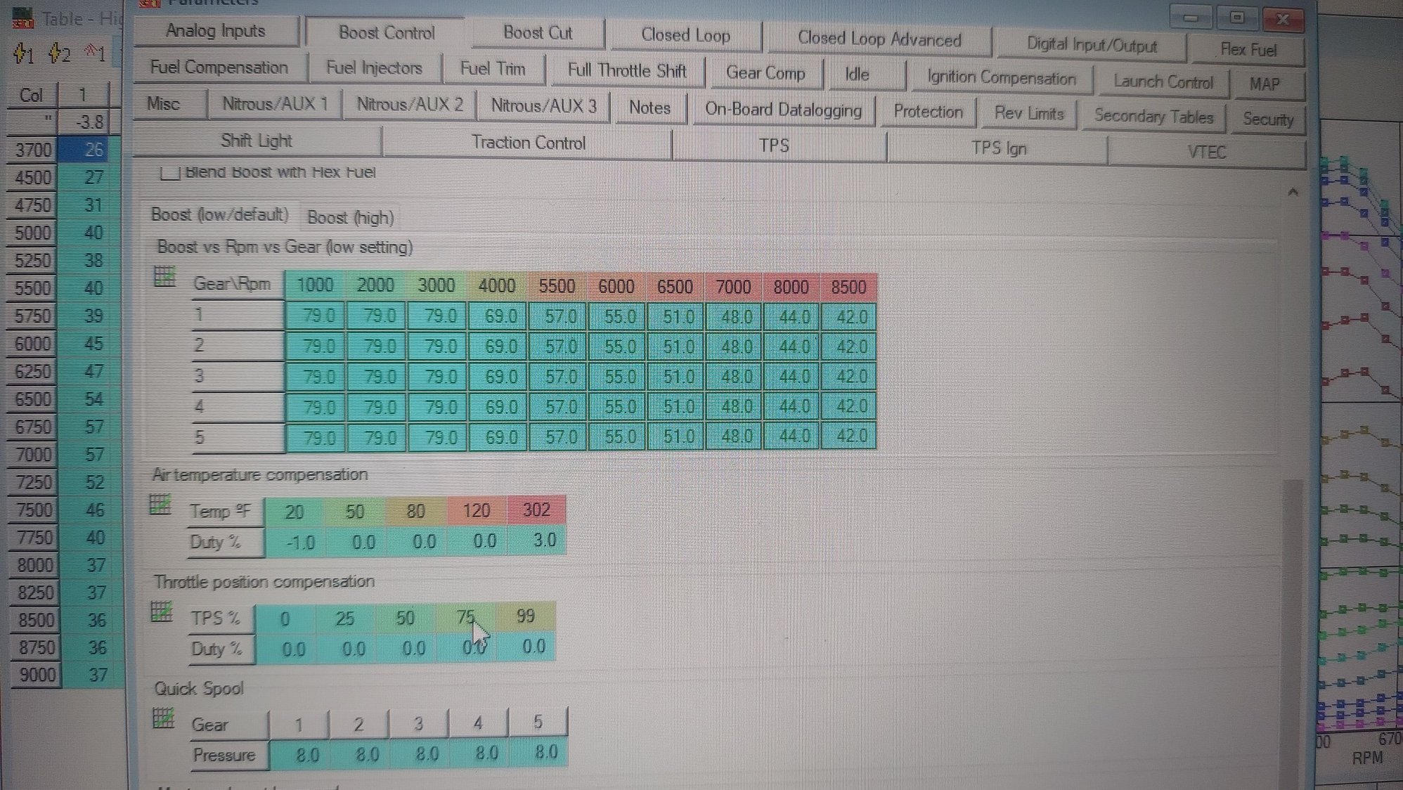

So, we had to taper the boost tables to resembles a S/C torque curve. IATs stayed at 90°, injector duty cycle is down and holding around 60%. With the turbo maxed at 31psi, we put down 479whp/342wtq. Says around 31-34psi theres little to no gains. The graph on the tables show the fuel just stacking on top of each other. Meaning turbo or engine isnt moving anymore air.

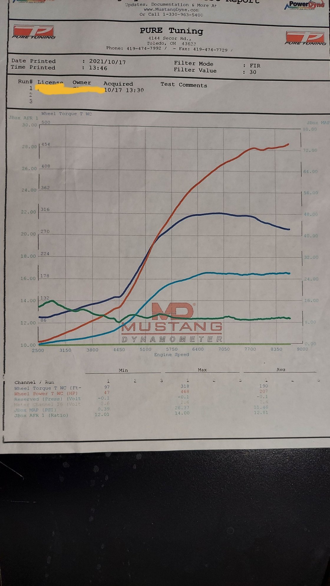

I seriously dont believe i dont have enough motor or turbo. However, those 479whp/342wtq measurements are being seriously underrated by the awd mustang dyno. Understand theryre just numbers, but dynojet will be around 560whp. Will be getting there soon. That also means im right in the range that garrett says the gtw3476r is capable of.
I seriously believe the intake manifold needs to go. Ive been leaning towards the victor x. Cams are also a limitation at this point. Pro 1s or maybe tuner 2s. The head flows numbers, i just feel the manifold and cams will free up alot of air to move out of the turbo. Not bottle necking the spec h ported pure tuning head job
Im gona post some stuff up very soon. Dyno sheet shows a tapered boost and torque curve to help with wheel spin. Will be able to see how he had it setup on the boost tables to accomplish that. Also will post up my adjustments ramping dem shitz back in like a bat out hell. As i dont have to bad of traction issues after a few pulls lol. The tables showing how the 30-34psi range is at its efficiency range. Video is just kinda blah. But viusal aides coming soon.
this is how the tuner adjusted the tables to make it easier for him to tune it. Due to wheel spin
these are my adjustments afterwards
high cam fuel table
Finally the dyno sheet that just shows numbers, and the setups curve with the boost table tapering in. I rev to 9500rpm, he just cut it off there. And overlayed it compared to last years results
The two vids i got werent really spectacular. One is just a high boost high revving vid. Other is one of high boost ramping in pretty quick. After i get time and my gopro charged, im gona start recording more

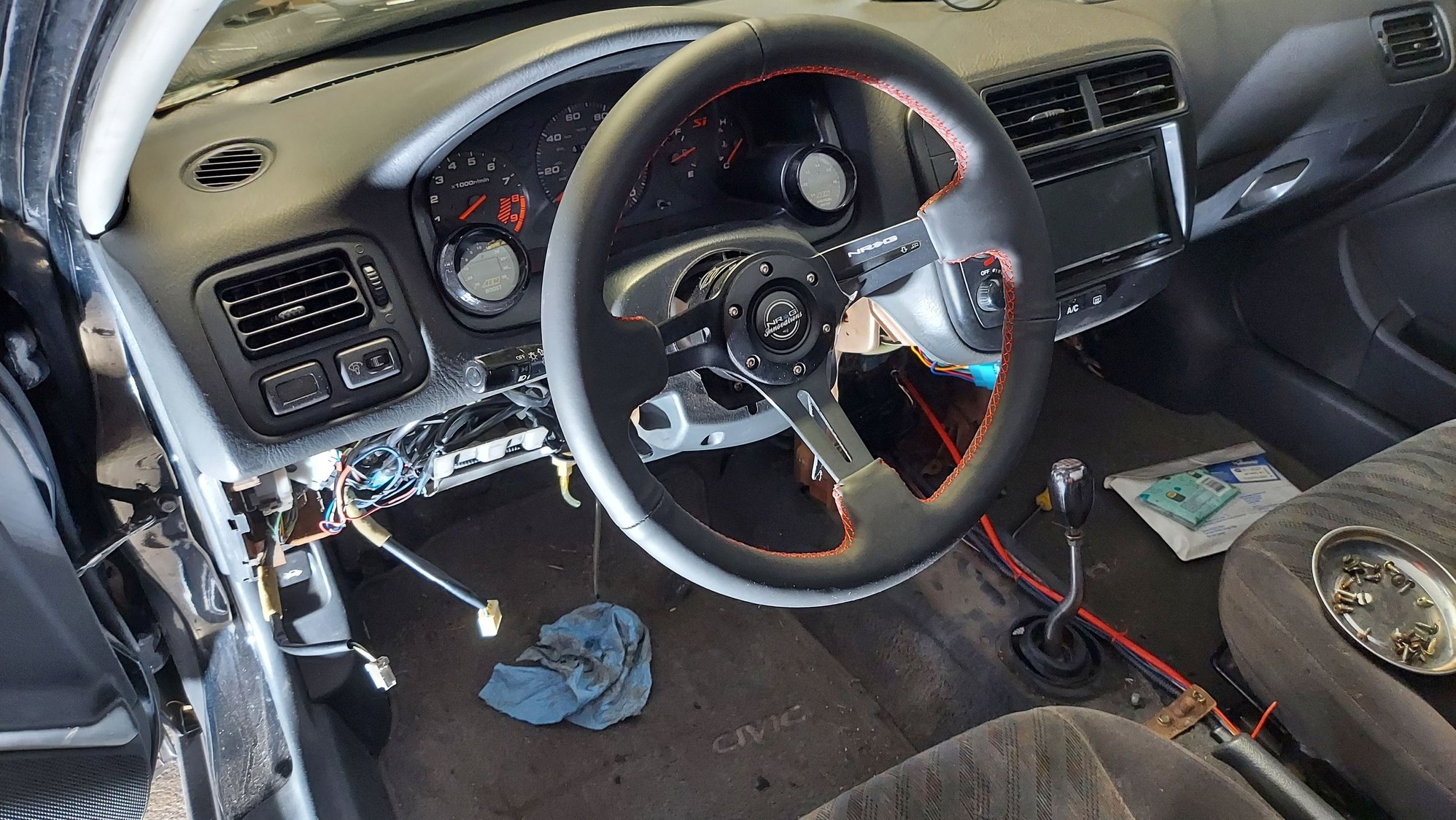

Baby step progression. Sneak peek
Will post picks when its installed. Tomorrow or sunday. Still gota finds some resistors. Also looking for an oem airbag delete tray. However, i mite be limited to carbon fiber. Which i dont really want. Wanted to do all interior stuff. Will prolly still look into sparco or recaro seats. But will have to hold off on seat belt harness. Because i need to read up more on the safety and reviews off harness bars. A roll bar setup like autopower would prolly work, i have a feeling they need welded in though. I need these items because im a big guy and i slide around alot.
I also have a parts list saved for an oil cooler setup. At that point i will also adding in oil pressure, oil & water temp guages

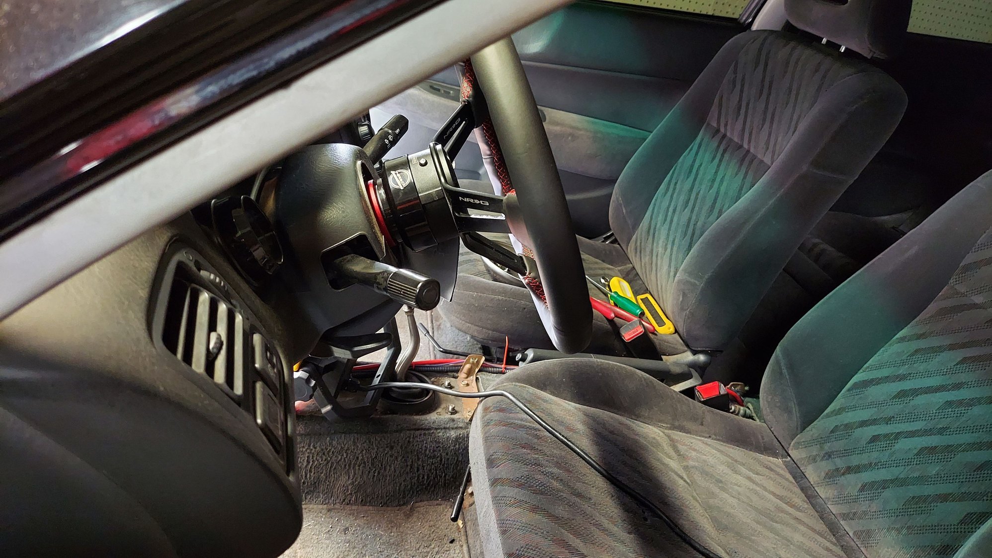

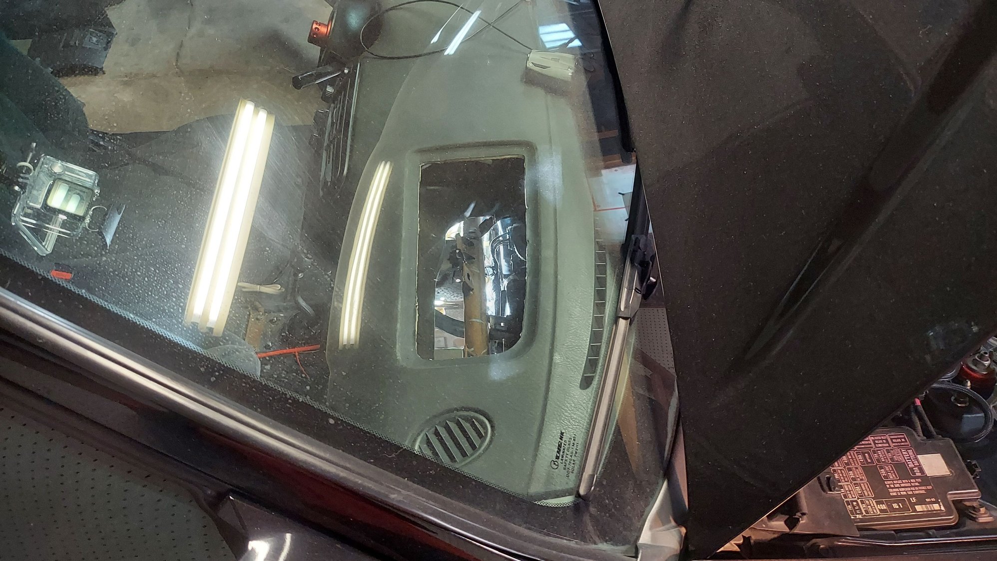

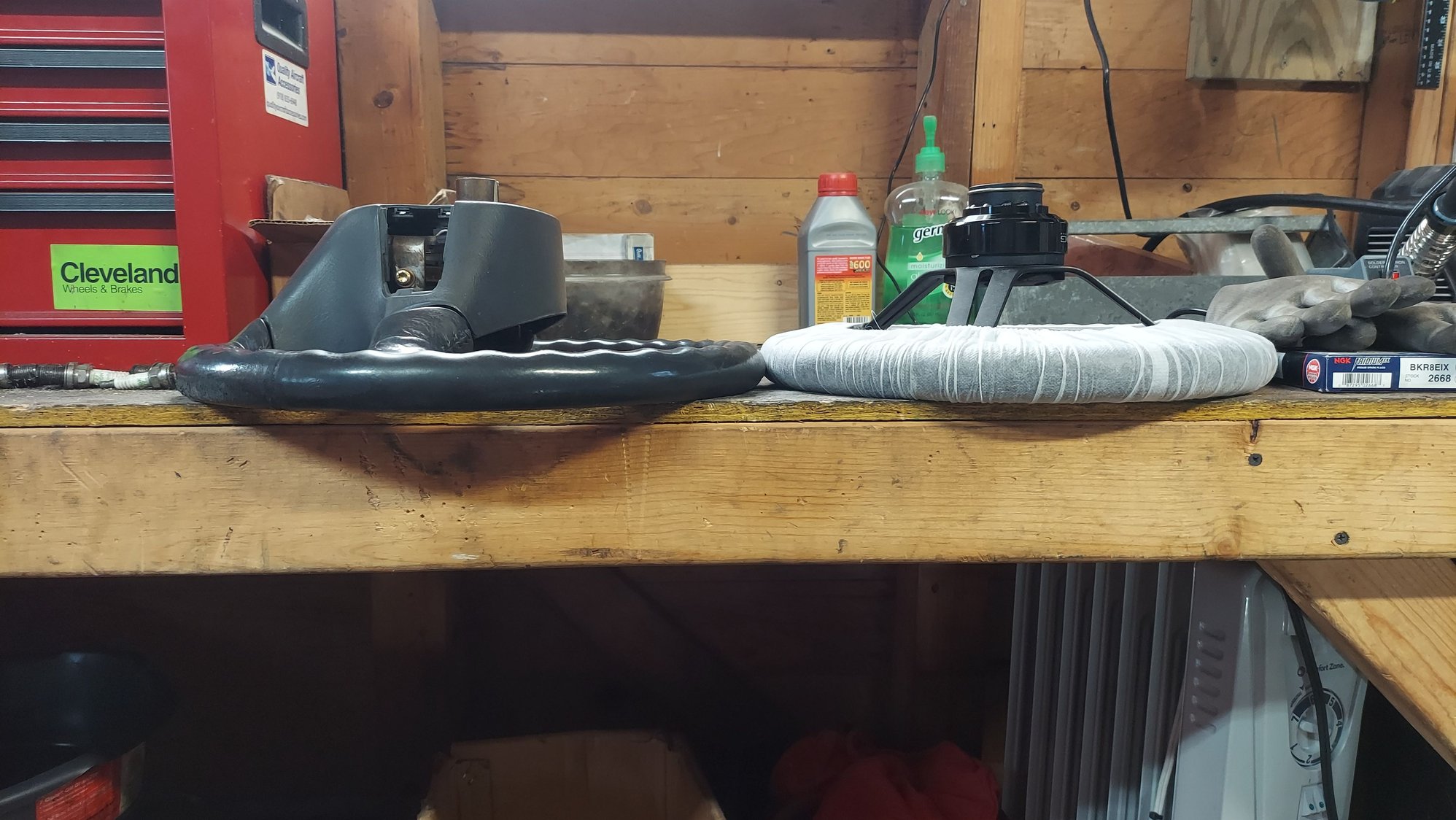

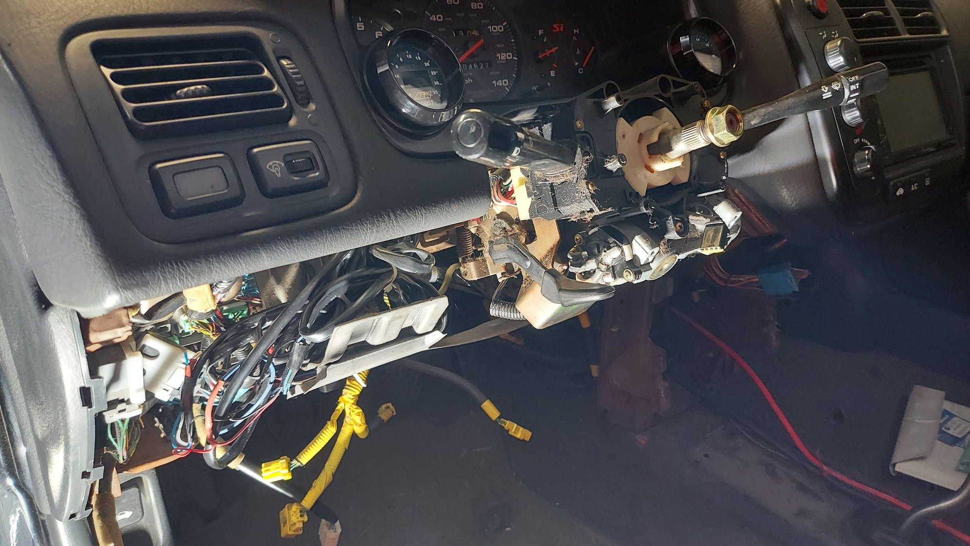

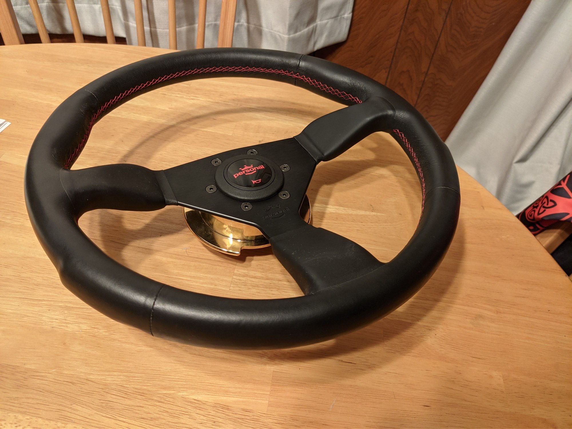

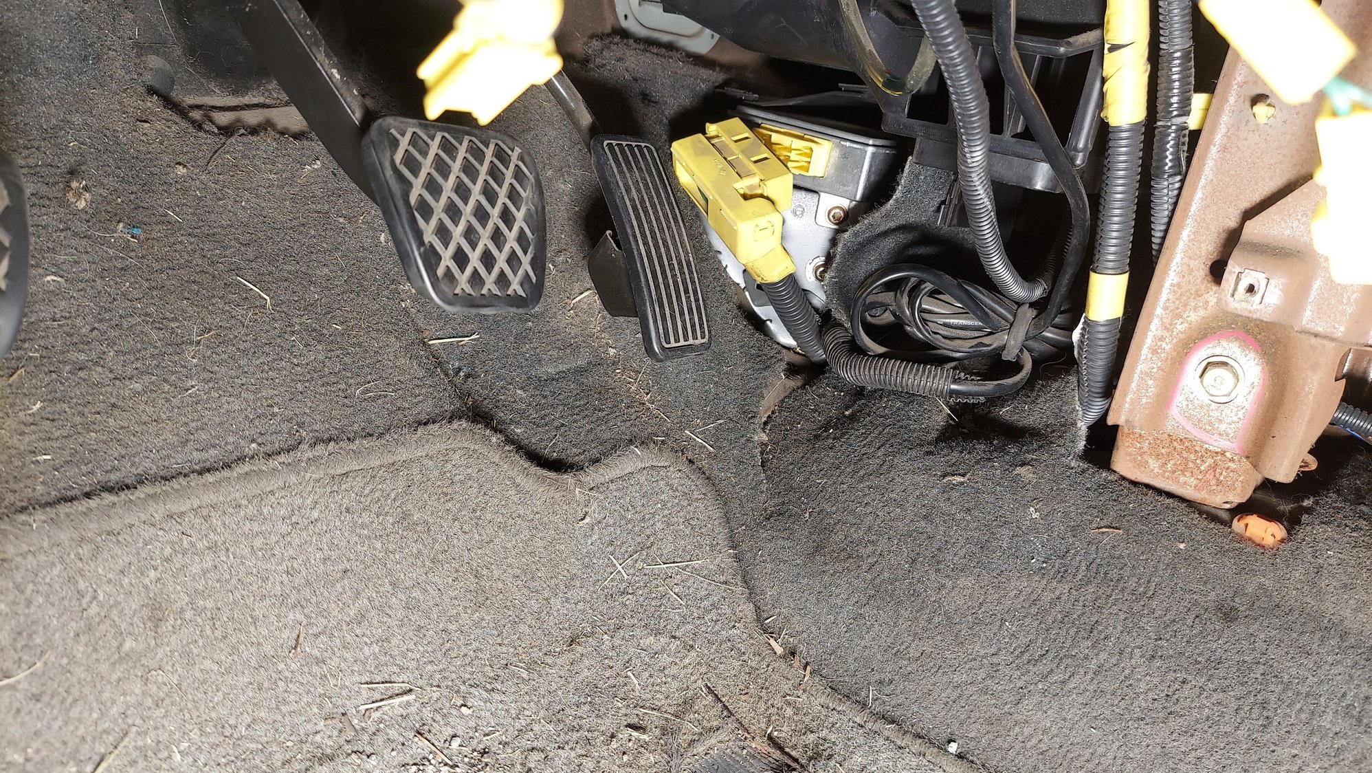

Today i got the steering wheel removed. Along with all of the srs equipment. That includes both airbags, harness, clockspring, srs module and cover intact. All in all, i removed 20lbs of weight. But the nrg wheel, race hub, and quick release weighed 4lbs. So 16lbs...woot woot
Will note that, the 350mm steering wheel is about half an inch short in diameter. Compared to the oem diameter

Posts: 1,394
Likes: 276
Default Re: ''simply BLACK''
Theres a ton of weight in the dash.

Very nice. Your NRG wheel looks pretty similar to my Personal Neo Grinta (black leather with red stitching, also 350mm)

I bet. Losing alot of weight loss wont help my traction problems at the moment. With this more power, itll just have me spin more. After getting some better tires, and removing some more weight, will be considering a weighted plate for up front to help traction. And mounting some things.
Thanks dude. Really? After seeing a couple bad steering wheel failures, i was looking at personal/nardi, sparcos, and momo. I just didnt see any that really stood out to me. Especially for the price. However, i somehow landed on a video of the nrg guys doing some testing with different steering wheel under a press. After that, i was okay purchasing their wheel again.
For years i wanted an s2000 cluster, with a ctr steering wheel. But neither of those was gona happen.
