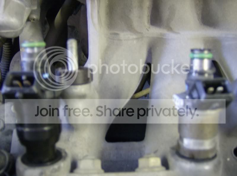

I just got my turbo kit in from Autoworks and it came with 440cc precision injectors. They didn't come with the bushing for the IM, just the o-rings on the injectors. When I went to install them they wouldn't sit in the stock bushing all of the way. Do I just lube them up and put the fuel rail back on and tighten it down? Or do I need to shave some off of the inside of the bushing?

for my rc's i shaved some off... I would assume that you have to do the same for the precisions.
Looking at the pictures, it definitely looks like you need to trim some down...
Try a dremel.

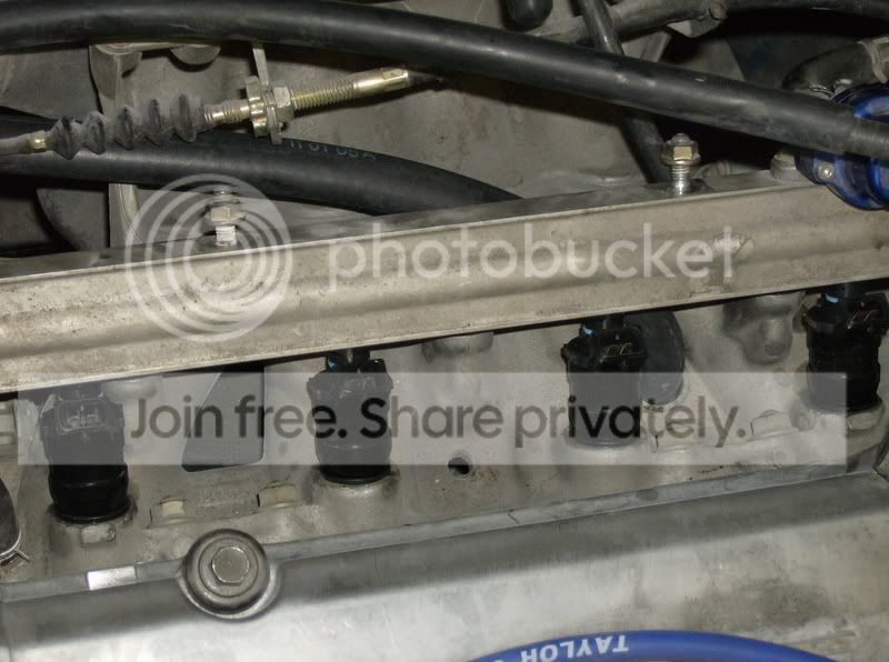

I just put the Fuel rail on and tightened it down. Fit perfect IMO I think that is the way to go.

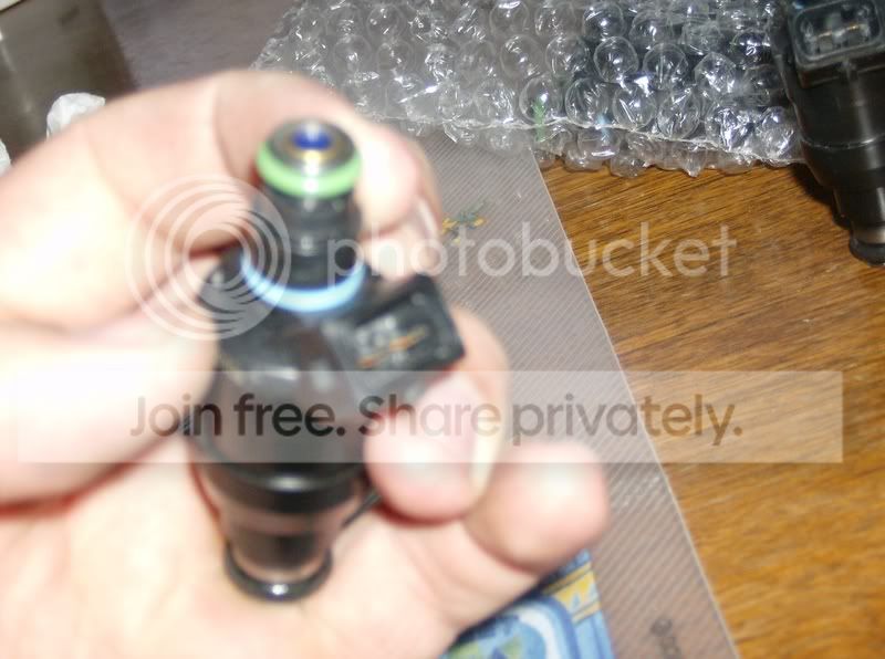

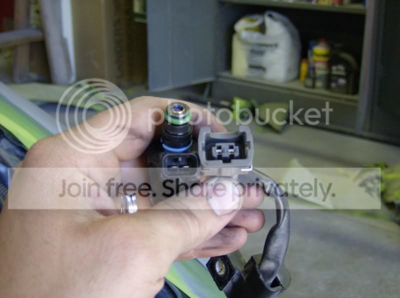

They didn't exactly snap into place, but they went in with little effort. I was just expecting them to go in like the stockers. So I got them in and went to connect the plugs and they wouldn't go in. After searching for the reason I narrowed it down to the little nipple, inside the center section, by the metal prongs. You can see what I'm talking about in the pic of the 2 injectors in the manifold in my first post.

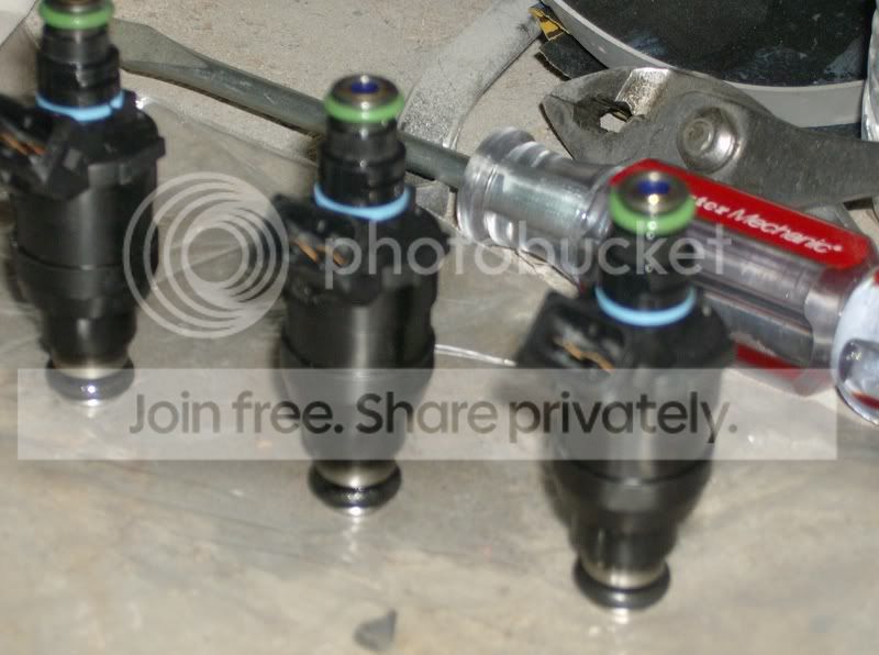

Here are some more pics of them installed and with the injector next to the plug.

Problem solved! *edit* You can tell on the one in the top right corner better!
