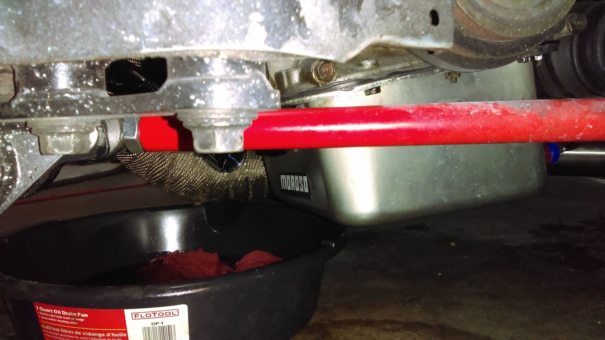

This is what i did to my pan
The baffle and angle of the pan is almost positive flow.
Here's my drain setup and everytime I run it I get oil blowing out of my exhaust after 5-10 mins at idle. I shut it off, pull my drain hose, and a qt. Falls out of the front fitting everytime. I have everything vented and turbonetics tells me the seals are blowing out from backup from the drain hose. I also, have a friend with no issues and a moroso oil pan, and another friend who has issues unless it's a qt. Low on his moroso. I have old school mounts that push the motor to lean forward more than most which could be an issue. I'm glad to hear you have no issues with your moroso pan, I think it has to do with my bottom Ramhorn mount and large turbo so close to the pan (small hose) that makes this pan not work for some? Turbonetics told me the moroso pan is my issue, I am going to try out the 5.5qt moroso since you and a few others have had positive results with it and see, with the baffle removed, if it fixes the issue. Thanks for the reply.

That was an old picture, it's now Re-installed. When I pulled the pan out I had all the oil in it (4qts) and it was below the baffle level. I put about a qt through the fitting with a funnel when it was on the ground and it stacked up on the baffle and took 30seconds to drain through the cracks around the baffle welds. I then drilled 15holes in it and it just drained easily through them. After Re-installation I added 4qt again and it blew out the exhaust after 5-10 mins of idle. I then opened the drain line and about a quart came out and my oil level on the dipstick was under the low level hole (about 3qt). I again started it and again it was blowing out of the exhaust once it was warmed up. I think once the oil falls from my windage tray and lands in the front side baffle it adds to my drain line oil and backs up once it's nice and hot like taffy? My oil pan compared to the horizon line is almost 30 degrees downward. I do have the restrictor on the feed side and at first I'm at around 80-100psi, once it hits 60psi then the oil starts coming out me exhaust and glorious white smoke, lol. I'm also starting to think I got sent a non vtec pan that doesn't compensate for as well for the angle? Stuck on it.
Old 09-06-2015, 02:05 PM
Myaccordruns13s's Avatar
Join Date: Sep 2015
Posts: 4
Default Re: oil drain line backing up using moroso oil pan.
That angle compared to horizon line
