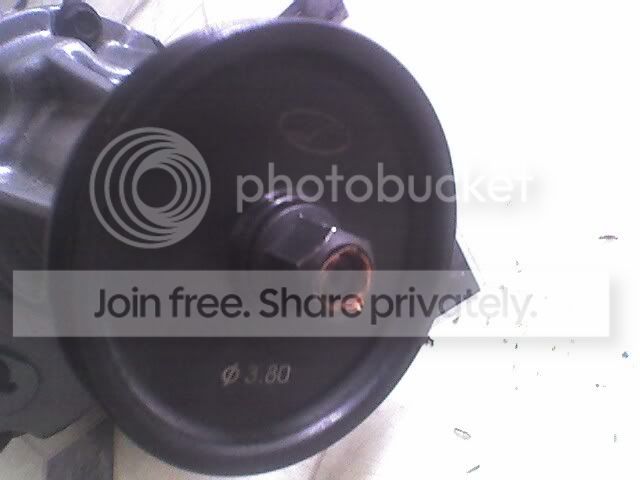

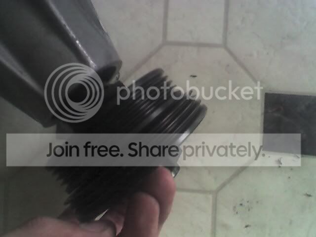

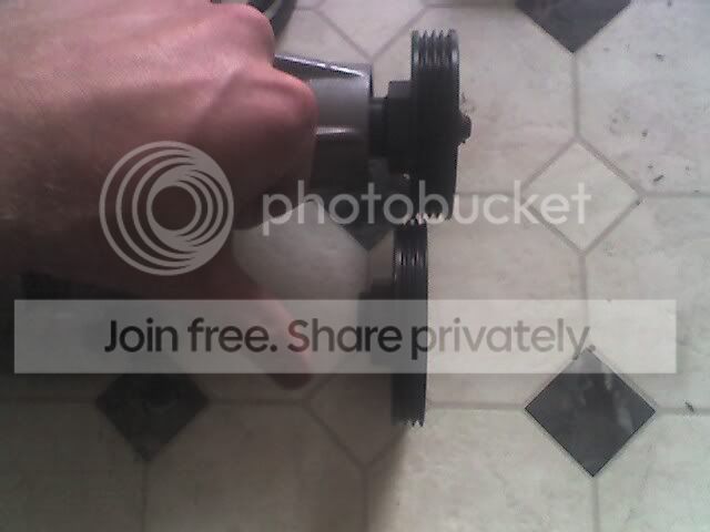

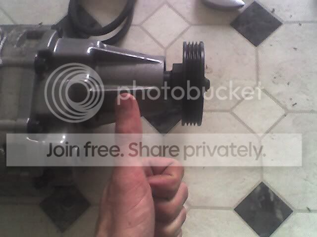

Got my new pulley today . Its a little smaller diameter which is great and its a 4 rib so when I throw the y8 crank pulley on it will work great. It also takes care of the belt alignment as well . My intake mani should be done by tomorrow and I might ditch class this Thursday if its not raining and put the bitch back together. Here are some pics of the different pulleys and the solution to all those using the later model kits with the older model engines.
p.s. I did not need a pulley puller to get the snout off it came off with my hands, I guess im just strong like that lol /

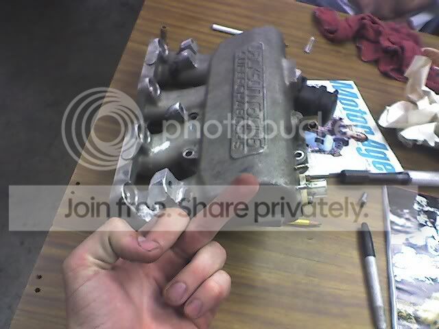

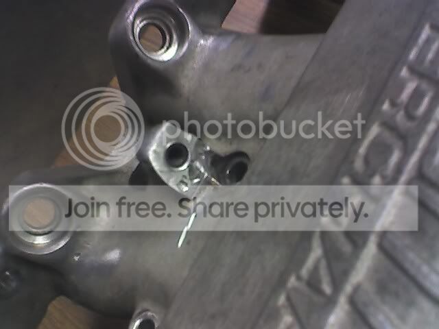

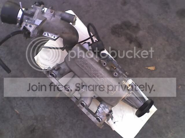

Got my intake mani back today I resleaved it and had my welder reweld all threw stud posts due to cracks. This was the bitch that held back the instal. Cant wait to throw this together Saturday hope all goes well.

What dumb *** did that to your manifold?
<TABLE WIDTH="90%" CELLSPACING=0 CELLPADDING=0 ALIGN=CENTER><TR><TD>Quote, originally posted by 8atman &raquo;</TD></TR><TR><TD CLASS="quote">ok SC is out of the car I should be getting my new belts and snout pulley tomorrow I probably wont have the time and daylight to get it up and running untill fri.
the mani is now off and on its way to my aluminum welder to be fixed . Wish me luck guys.</TD></TR></TABLE>
Old Nov 16, 2006 | 08:54 PM
  #449
8atman's Avatar
Posts: 2,306
From: so cal, ca
Default Re: (1 Fly SI)
The original owner hacked up one of the stud posts and joe rigged it up so that I could get my car home. JB weld for the win lol .
Old Nov 16, 2006 | 08:57 PM
  #450
1 Fly SI's Avatar
Posts: 2,246
Default Re: (8atman)
Did he not know how to relocate the regulator?
