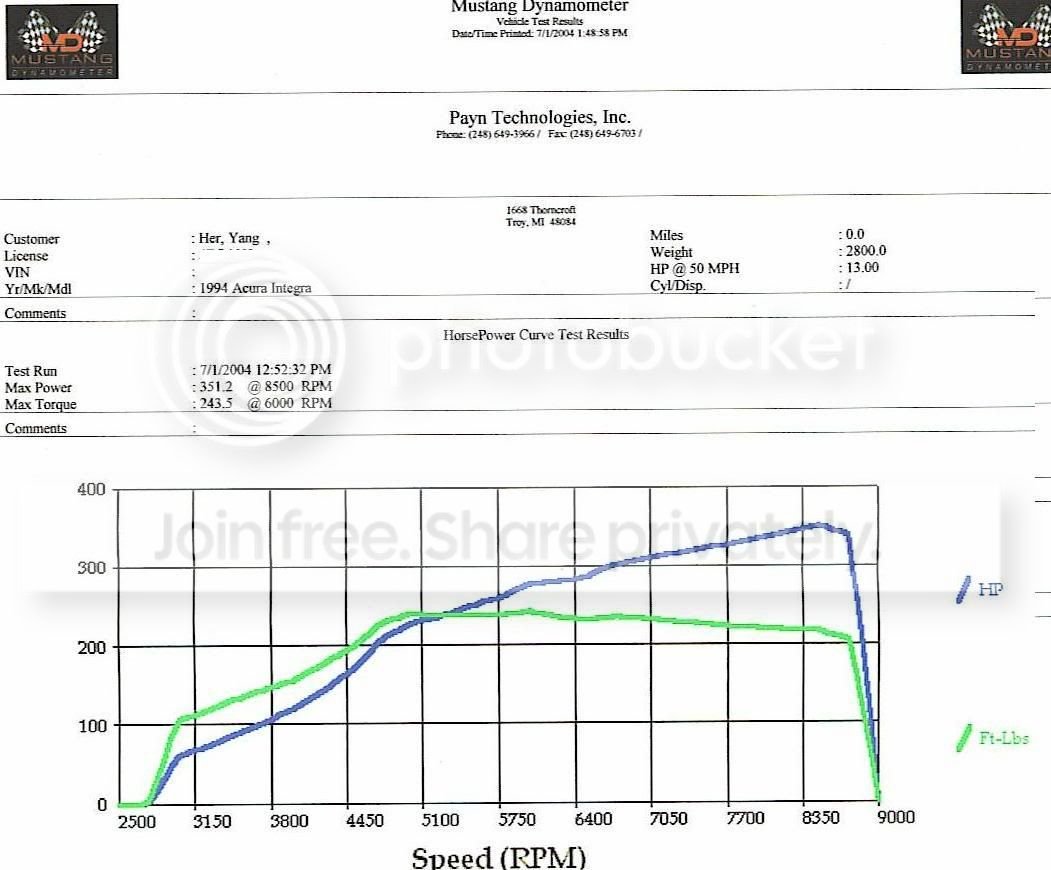

I just dynoed my new setup today on a Mustang Dyno @ Payn Tech.. took me about a month getting it all together for today too.. the last week was pretty hectic, had to completely redo my oil return line cuz it was leaking..
anyway, I managed to pull a best of 351 HP/243 TQ w/ my fully built 84mm sleeved GSR on Pump Gas .. Tt was a great jump from my last tuning session in which i only pulled a mere 197 HP last fall...
Here's my Setup, Let me know how i fared to others out there w/ similiar setups..
Hondata S200b
Benson Sleeved 84 mm bottom end
9:1 weisco's / eagle rods 3/8"
REV valve springs
SC61 @ 16-17 psi
PTE 600 HP FMIC
JG IM
750 RC's
3" full exhaust & DP
RPS clutch
2.5" charge piping
walbro 255
& some other stuff...
I"m hoping to run 11's this saturday, but will probably actually do low 12's realistically..

Congrat! Nice numbers...but still a little low for the boost you're running. Mike01GSR made over 500 with 18psi. I'm thinking you should be around there too no? But still great numbers.

not bad at all. on a dynojet youd probably be around 380whp

Nice numbers get some REAL gas in there goodluck at the track

well we put in 100 octane and boosted up to 20 psi.. the car started misfiring up top, so we stopped and just called it a day w/ 17 psi.. it seems my stock ignition isn't cutting it w/ 20 + psi....
overall, i'm happy w/ what i got today.. btw, my 1st pull of the day netted 315 HP on a base map pull.. That suprised us all...
i've got to get used to this power b4 i decide to upgrade my ignition and pour race gas into the mix...
