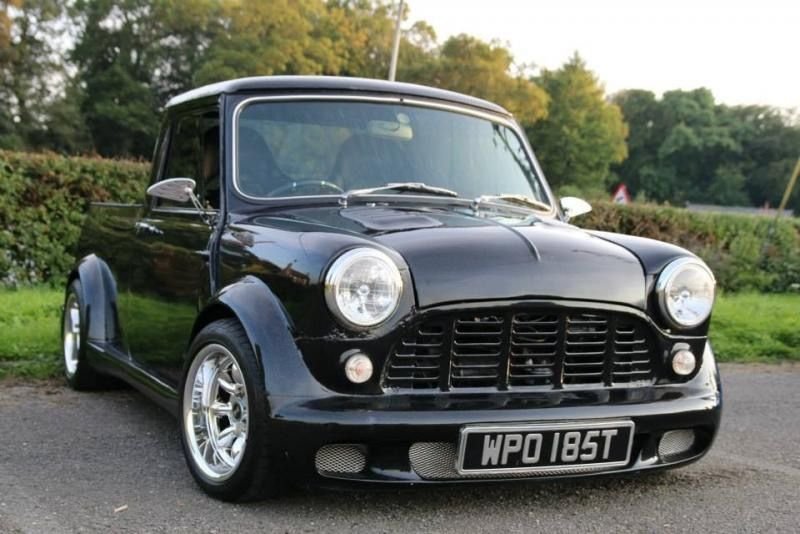

Default re: 1963 Austin-Mini pick up B16A2 turbo build: What's the potential?
Not this
Thanks for the reply's. I have seen the Mighty car mods video on vtecing a mini. I'm using the same engine cradle they are but also the rear end kit to put a CRV diff in the car. AWD but low. More like this.Where is a good place to find a computer for my B16a2? I didn't get one with the motor. I plan on running a Hondata piggy back.
Thanks
Charlie
