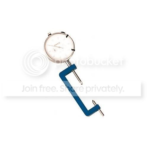

BTW: Bought this just now.
Damn I am being thorough with this engine build.
