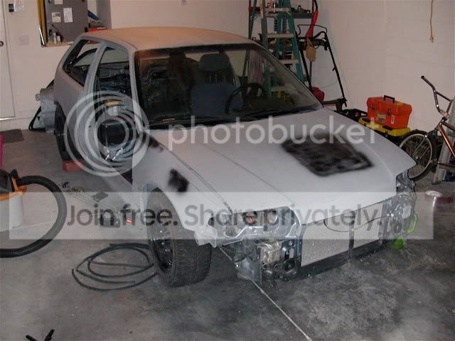

"booth" looks good would have never of thoughten to put the exhaust fan in

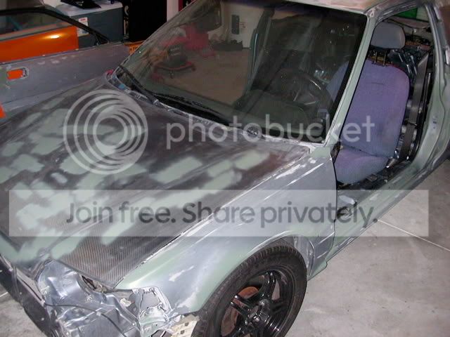

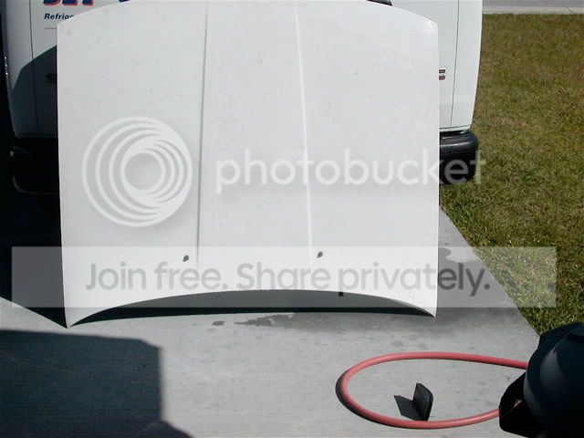

the cf hood was too far gone to be saved. painted it white, blocked it, filled all the low spots with spot putty, blocked it again and sprayed self etching primer over the filler afterwards.

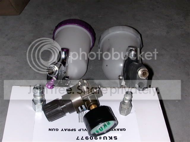

new hvlp gun arrived (left). it's air consumption is equivalent to the output of my compressor when set at the manufactures spec of 30 psi. notice the difference in the ID of the air inlets. the new regulator is a restriction so it won't be used.

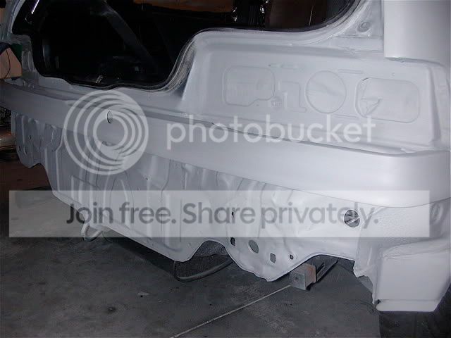

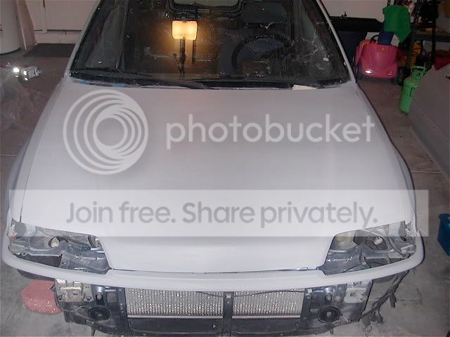

primered the car. 3 coats on the fender and hood and 1 coat on everything else. The new gun laid down the primer nicely w/o orangepeel.

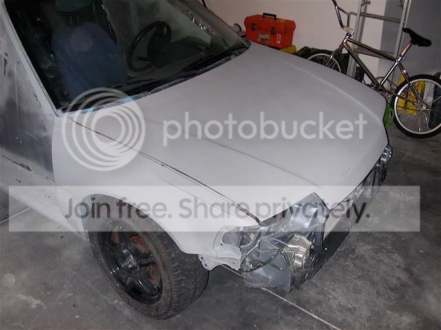

found a crease above the wheel well on the fender and a big low spot in the hood afterwards. fixed the hood and crease. that bondo spot in the corner looks better but not good enough so a new fender will be ordered.

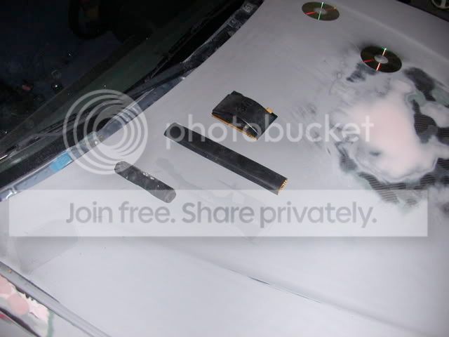

since that 3m sanding (right) block doesn't work too well and made more work for me i made my own. I wrapped a 12" level with paper and used this to block the hood and the doors. The block on the left is a piece of insulation with 3/8" coolant hose in the middle. worked well for blocking the hatch, 1/4 panels and curves on the fenders.
thank you. when the fan is on there's negative static pressure in the garage. I think the fan will work better if the door is cracked and some air is actually moving.

i've heard good things about the brand. the assortment of tips is a plus. if you have a compressor that puts out 15 psi at 30 psi they should work well. if you're using a 120V compressor find a different gun that requires less air.

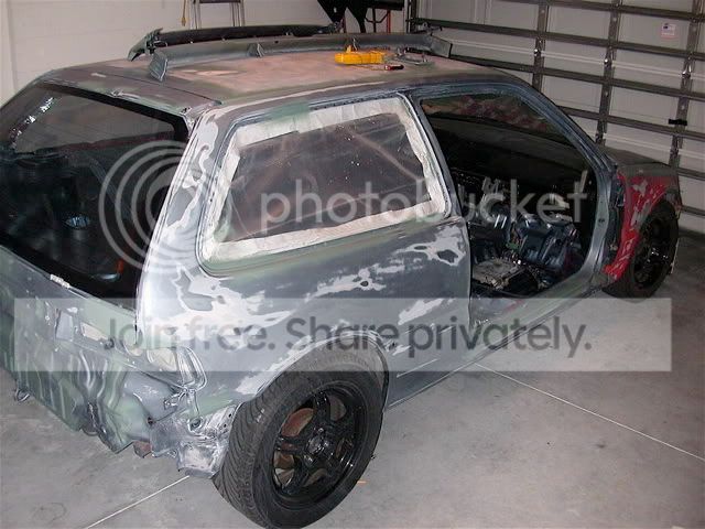

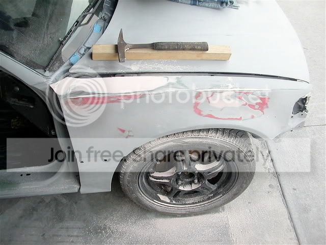

a new fender costs too much so i had to fix the other one. it was full of high spots so i leveled it with a 2x2 and a sheet metal hammer.
primered the car and wetsanded with 600 grit. i really like the gray primer that still remains on the majority of the edges.
there were two tiny spots of bare metal after sanding the rear of the car.
the drivers side door needs to be blocked again. the rear spoiler need to be blocked and primered . still haven't removed the hatch yet and sanded that door jam. i'm going to try to get it done this weekend.

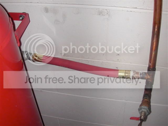

I think you'll end up panel painting with that compressor. What's the specs?

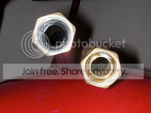

picked up a custom hose with 3/4 NPT female threads on both ends (right). Tightened it up and it started to leak at 20 psi. Took it back and told them it leaks between the crimp and the connector. They remade the hose (left) and now it's airtight. The fitting on the right is made out of brass and tapered at the end. it wouldn't have leaked if i was using brass fittings. I'm using galvanized steel and copper which is flush at the end. The fitting on the left is flush and uses a rubber washer to make a seal.
hose installed. looks cleaner and more importantly it's safer.
