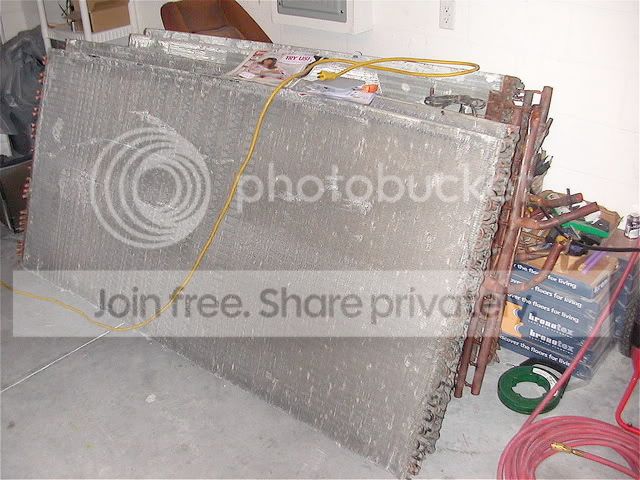

update- if i took these to the recycler as is i'd be paid for "irony aluminum copper".
value increases when you sawzall off the u-tubes and copper headers. after the copper is removed use a hammer to remove the sheet metal on the end. after the coils are chopped up you're paid for copper and radiator. recycled 531 lbs of radiator and 42 lbs of copper.

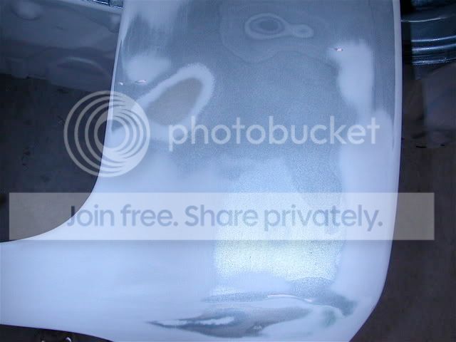

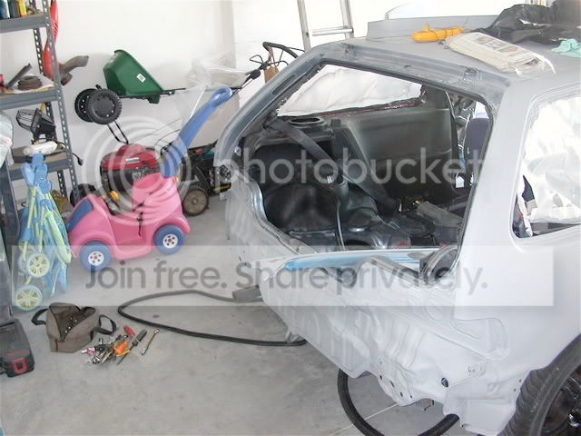

finally got around to removing the rear hatch. after this jam is primed/sanded the car will be ready for paint.
primered the drivers door and rear spoiler. accidentally ran over the fuel filler lid when pushing the car into the driveway.

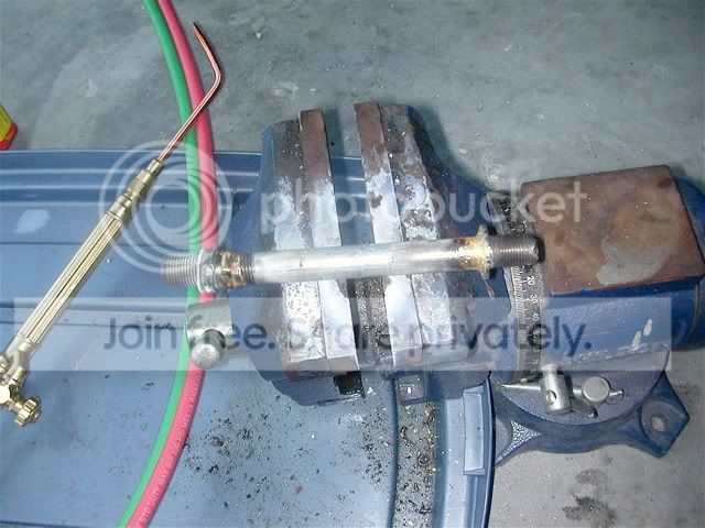

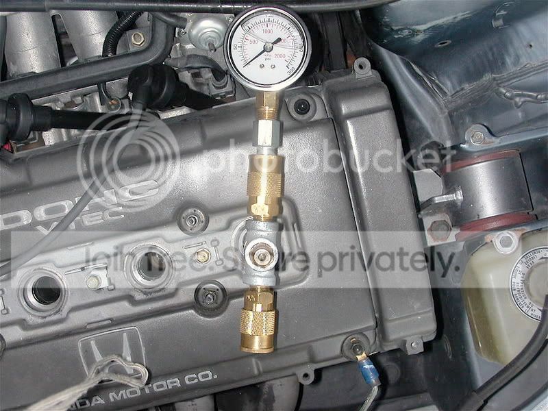

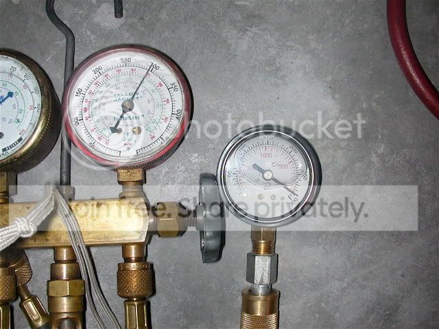

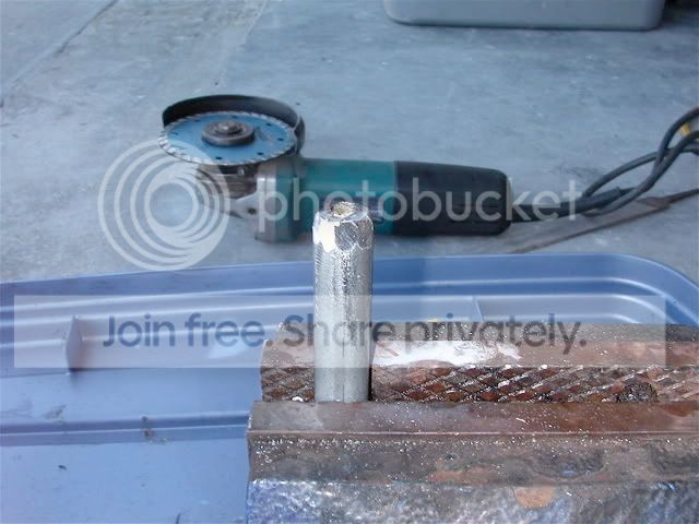

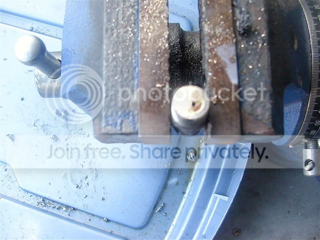

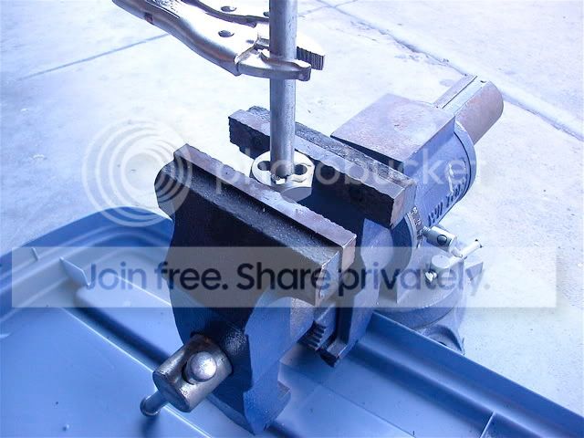

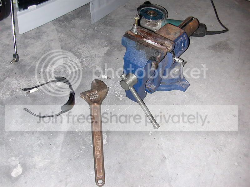

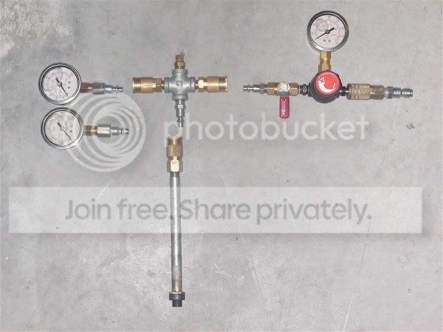

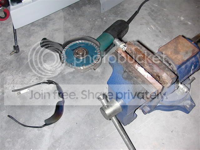

built a leakdown/compression tester. here's the pics from start to finish. if anyone tries this wear safety glasses or a full face shield when welding or brazing. also keep in mind this tester will see pressures from 100-200psi maybe more. double check everything and be safe when working with pneumatics.
started out cutting through the insulator/electrode right above the hex nut with a grinder. on the bottom i cut off the insulator/electrode and the gap. My cutting wheel quickly disappeared. switched to a diamond blade that cut like butter.
it takes a couple light taps to push the insulator out through the top.
change of plans.
I cut the 1/4" npt threads off an 8" galvanized pipe nipple and tried to rethread it using a m14x1.25 die. the od of the pipe was bigger than the id of the die.
too hard to thread it in straight so i tapered the end.
connection options. didn't spend too much time on this piece. it was used for r&d.
used bronze flux coated lincoln electric welding rods to make a restrictor out of an 1/4" npt close nipple. drilled a hole afterwards with a 1/16" drill bit. The restrictor must be installed after the regulator to create a differential and work properly. w/o the restrictor the tester is useless because both gages will read the same.

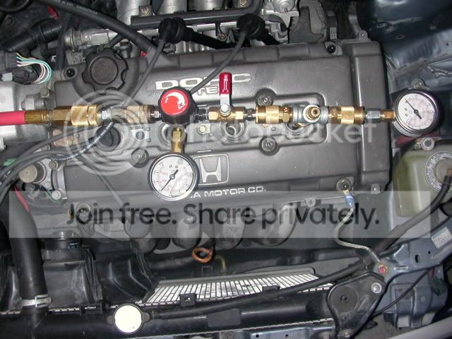

setup to do a compression test. liquid filled gage maxes out at 300 psi.
install the 100 psi gage, reg setup, compressed air and it's a leakdown tester.
a drain **** is installed on the top of the cross to relieve pressure. oem honda fuel injector o ring makes a seal between the head and tester. loctite 242 was used on all threads. pressurized it tonight. no leaks so far. gage on reg reads 100 psi and the other gage read 0 as i expected.
I did cyl 1 just for fun on a cold motor. Didn't bother finding tdc on the compression stroke. hooked up some compressed air and opened the valve. the crank spun around a few times i heard air escaping somewhere. covered the exhaust and the pressure built up.

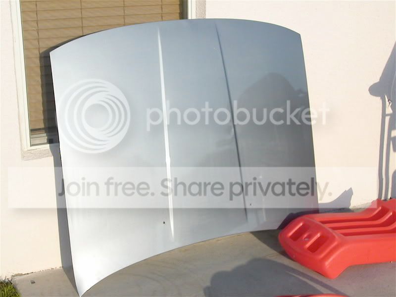

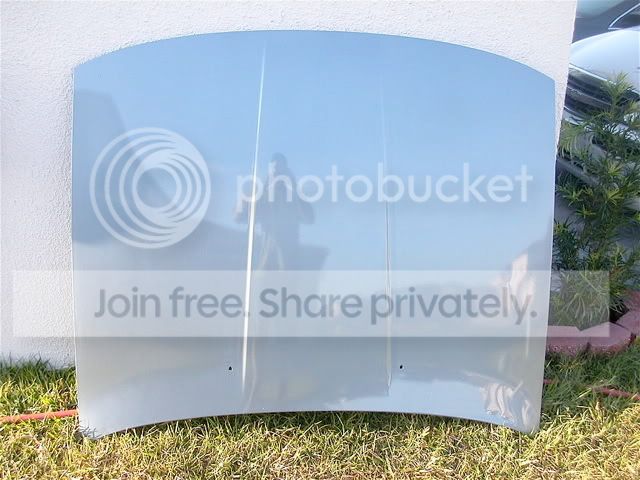

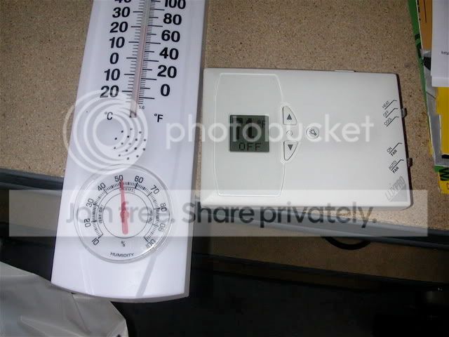

pressure tested the compression tester. Now i feel safe using it on the car.
ideal conditions for painting are 70 deg 50%rh. 71 deg and 52% rh today. told my wife i was painting and the smell would be minimal. "can't you do it tomorrow when i'm gone?" My response "no". sealed the door, air handler and attic and got busy.
practiced on the camry hood. this is my first time shooting base with the new gun, and first time using a basecoat/clearcoat system. garage door was open and the exhaust fan wasn't used.
4 coats of basecoat and 4 coats of clear.
The fumes didn't make it into the house. now that i can paint whenever i want, i'll be able to make progress and continue taking my time.
