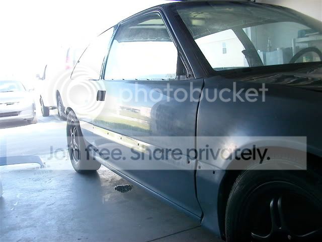

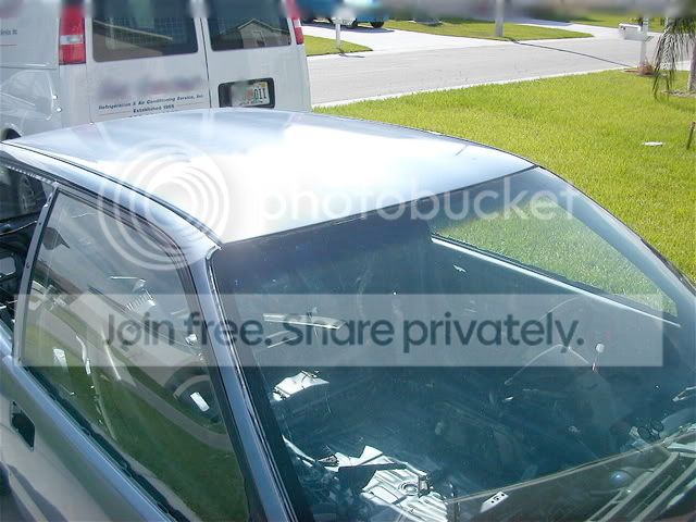

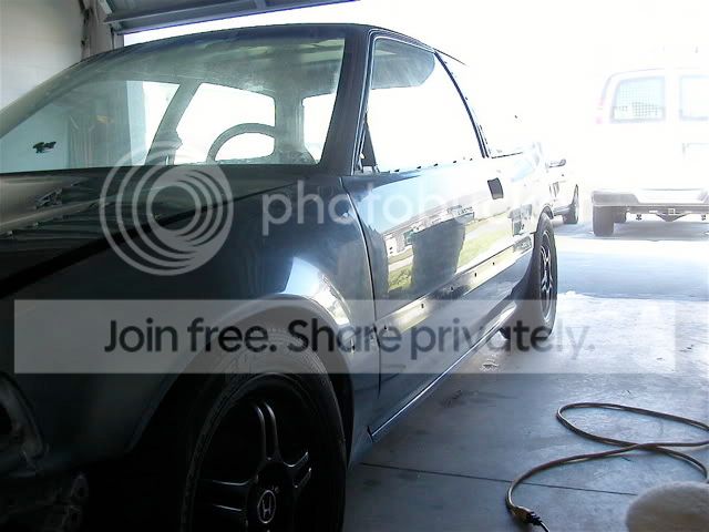

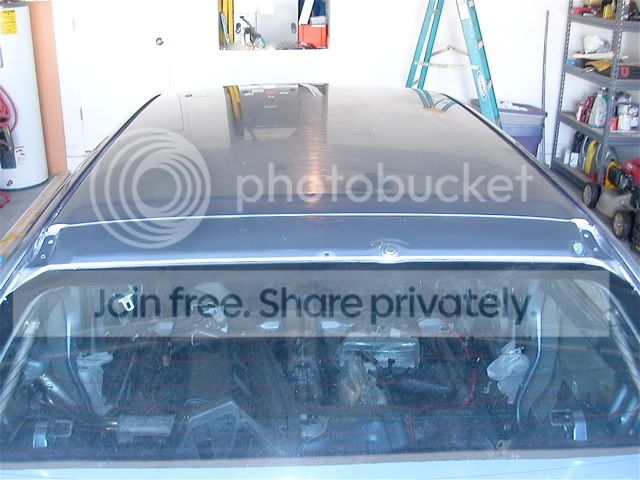

stripes on roof
buffed the hood. 1st time I've used a buffer.
car has mongolian spots
spot in the middle of the door. same thing happended on the first attempt.
I'm done painting for now...

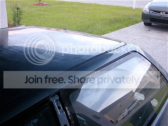

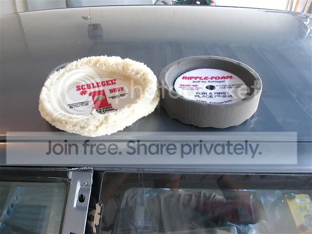

wetsanded with 1000, 1500, 2000 in an "x" pattern. up/down then front/back. after sanding i wiped the car down with a microfiber rag and once the sun evaporated the water i'd see the low spots and focus on those. repeatd the process sanding diagonally. leveled all orangepeel in 3 hrs.

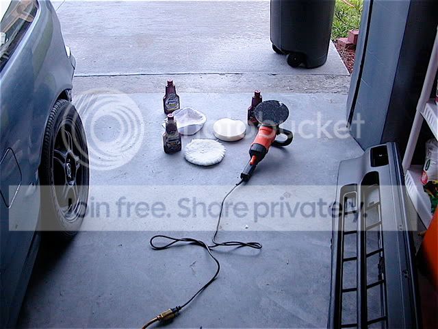

megs deep crystal system. step 1-paint cleaner. step 2-polish. step 3-wax
after step 1

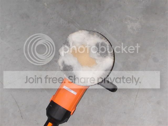

started step 2 on the l rear of the roof. i was enjoying myself until the buffer rpm started to drop. noticed the foam pad was started to get hot so i called it a day. I need to find a write-up on polishing before i continue.
thanks for the positive comments

jdmazm:thanks for the link. i printed it out and followed it the best i could.
CBURKE: i've heard it's best to wait at least 90 days before appyling wax. tintdude says i'm supposed to wax it after buffing. wax now or wait?
this foam pad was killed during polishing.
3M products would have been over $100 so instead I picked up some evercoat heavy duty rubbing compound and dark glaze foam polish and new pads. This black foam pad looks exactly the same as the 3M black foam waffle pad but cost 1/3 of the price.
applied compound to a foam applicator and buffed started at a low rpm. applied a second coat and increased the rpm. used water from a spray bottle for the third coat. wiped down the car witha wet rag and dried it. did the same thing with the polish. the third coat of water made it shine. finished buffing car this evening.

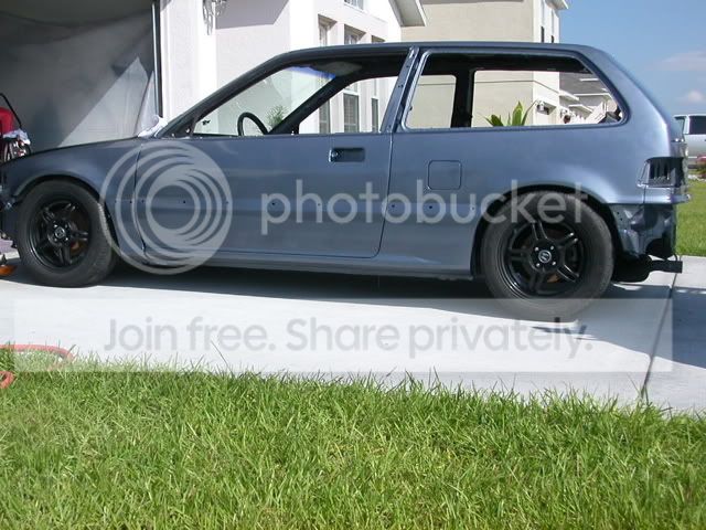

should have found some different wheels before i started this project. found overspray and hard water stains on the wheels. each wheel was removed, cleaned with paint thinner, sprayed with powerized windex and allowed to sit for 15 minutes, wiped down with a microfiber rag, hosed off and wiped down again. the wheels cleaned up nicely.

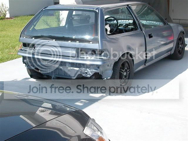

The old bolts looked nasty and the threads were rusted. went to lowes and bought new m6-1x16 bolts, 6mm flat washers, and 3/16 fender washers. when i got home i used a 1/4" drill bit to enlarge the hole on the fender washers.
back of the car is almost done. still need to use trim paint on the hatch moulding, order a new seal for the rear wiper. if you look closely you can see that there's a piece missing from under the spoiler. don't know where i'm going to fing this part at becuase it's discontinued.
