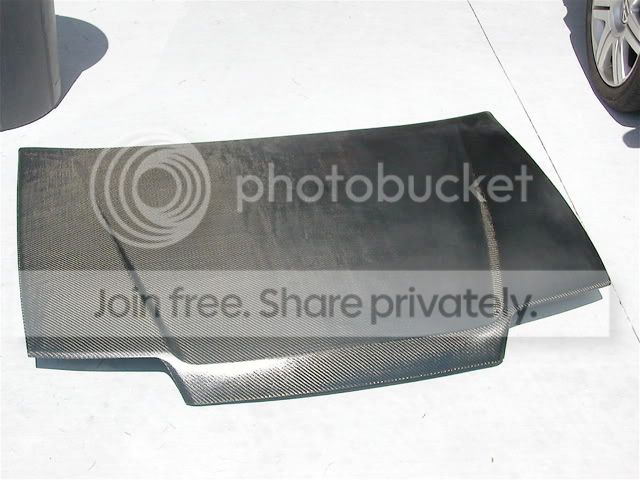

update-still waiting for fed-ex to deliver my parts. clear coated the cf hood and learned how to use the touchup gun.
<TABLE WIDTH="90%" CELLSPACING=0 CELLPADDING=0 ALIGN=CENTER><TR><TD>Quote, originally posted by joeny12985 »</TD></TR><TR><TD CLASS="quote">looking great and great deal on the paint gun. how much is it new new?</TD></TR></TABLE>

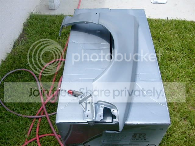

thanks. here's some info on the touch-up gun: .8mm tip, manufactured by american pneumatics, model # gf6. it's basically an imitation SATA touch-up gun. msrp is $117.

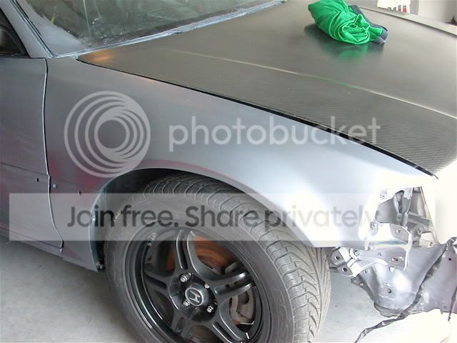

cleared coated the hood. layed down 3 coats. i allowed 30 minutes flash time between each coat.

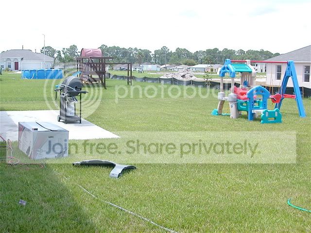

today's paint booth. air pressure was set @ 45 psi and the manufacturer recommended 35-40. Once the paint was mixed i tested out the gun settings on the box. as soon as i pulled the trigger i got a run. a quick fluid flow reduction and the gun was ready to go.

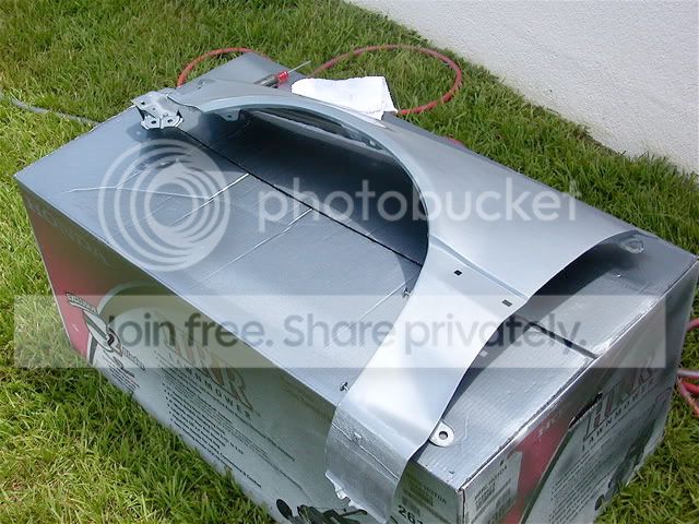

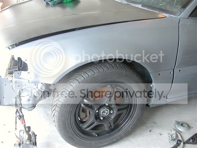

the edges on the wheelwell arch and bottom of the L fender need touch-up.
same thing on the R fender plus that spot above the bumper.
sprayed 4 coats and kept the gun in the refrigerator while waiting for the paint to flash.
results of touch-up session #1. no orangepeel btw

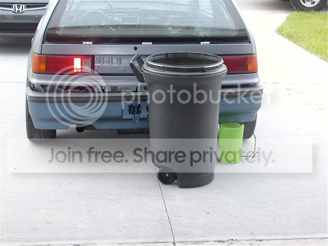

painted my raer bumper b-56m (saxony blue metallic) for practice. The bumper will be clear coated and then i'll do the front.

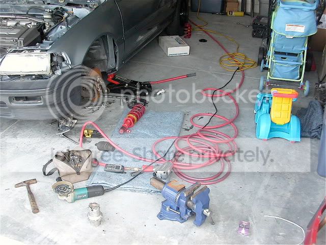

this is way too many tools for a coilover install. set screws were rusted so i had to use the grinder to remove it. then the sleeve was stuck to the shock and i had to use the sheetmetal hammer. The coilovers didn't come with instructions so i put the short sleeves and thick springs in the front. Long sleeves and thin springs were installed in the rear.
torque specs for rear: three bolts on rear lca= 40ft.lbs. nut on shock piston=22 ft.lbs., 2 nuts for mounting collar=29 ft.lbs.
torque specs for front: nut on shock piston=22 ft.lbs., 2 shock mounting collar=29 ft.lbs., upper bolt on shock fork=32 ft.lbs., lower bolt on shock fork=47 ft.lbs.

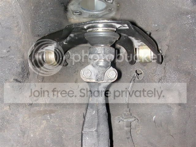

replaced front upper control arms. The upper arm bushings are torqued to 22 ft.lbs. upper arm anchor bolts are torqued to 47 ft.lbs. installed cotter pin in the ball joint threads and torqued to 32 ft.lbs.
here's how it sits after new front ucas and gc coiovers.
