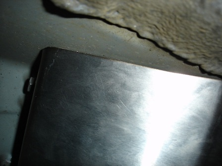

Car looks great!! Definetly reminds me of doing Nates K20R-R! Good luck with it and Im looking forward to see what kind of power you make with the Kpro......Nate, if your reading this you need to get on that
I was considering fabricating a skidplate for Nates project. Still may sometime in the future since he likes his car a little lower than where it sits now. I looked at it a bit and decided that bolting it to the lower rad support probably isnt a good idea since if something were to come in contact with the plate then you may possibly bend the rad support at the same time. To do it properly it should run up to the underside of the frame rail, or bolt to the block and be totally seperate of the chassis.

<TABLE WIDTH="90%" CELLSPACING=0 CELLPADDING=0 ALIGN=CENTER><TR><TD>Quote, originally posted by 93LSivic »</TD></TR><TR><TD CLASS="quote">Car looks great!! Definetly reminds me of doing Nates K20R-R! Good luck with it and Im looking forward to see what kind of power you make with the Kpro......Nate, if your reading this you need to get on that
I was considering fabricating a skidplate for Nates project. Still may sometime in the future since he likes his car a little lower than where it sits now. I looked at it a bit and decided that bolting it to the lower rad support probably isnt a good idea since if something were to come in contact with the plate then you may possibly bend the rad support at the same time. To do it properly it should run up to the underside of the frame rail, or bolt to the block and be totally seperate of the chassis.</TD></TR></TABLE>
Good idea! If you do fabricate something, make it strong enough to be a lift point!

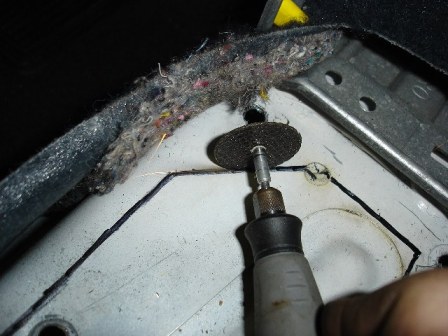

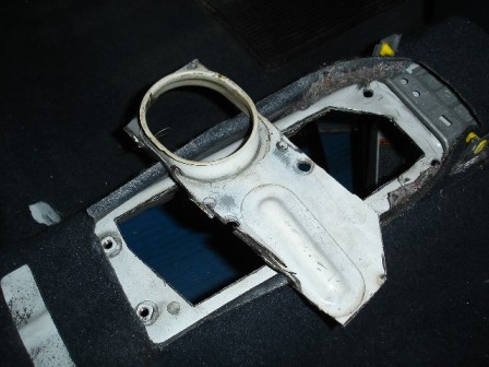

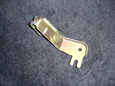

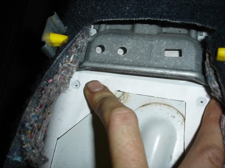

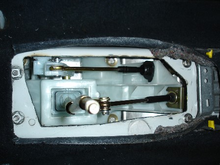

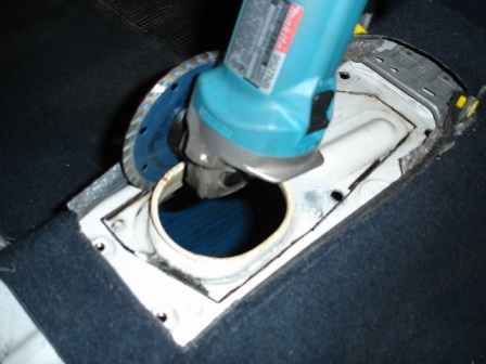

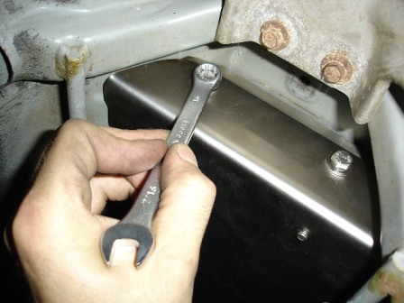

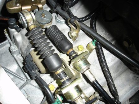

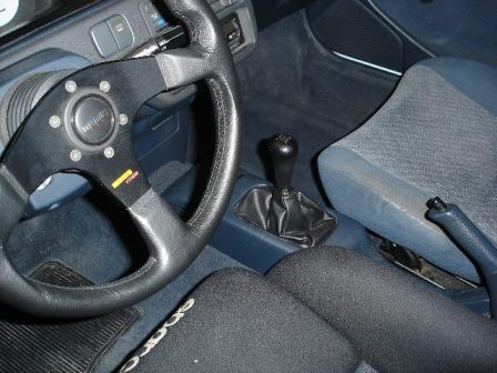

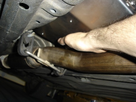

this is what I did for my car.. although an EG, I think it will give you an idea what is involved

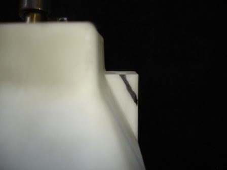

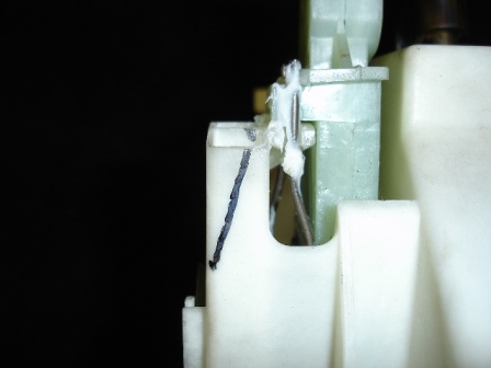

This is the shifter KIT I am using, from Karcepts.com

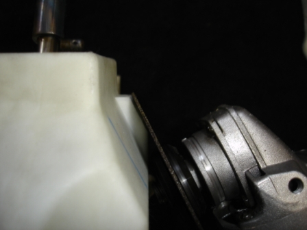

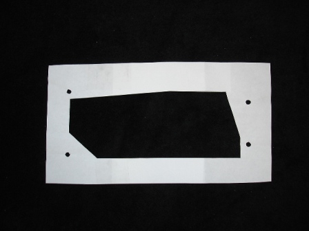

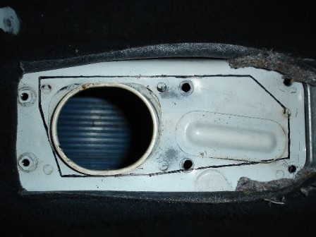

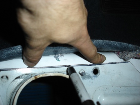

Shifter modifications (dimensions to cut will be provided in manual)
Simple template provided to help out
Grind the longer straight areas
Dremel the tight spots

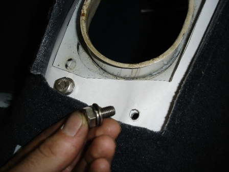

Rear mount
Attaching rear mount

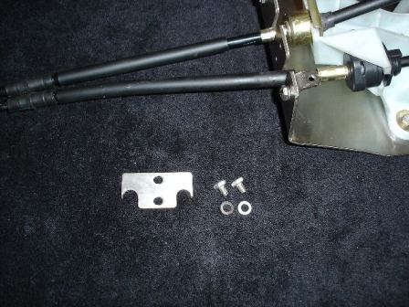

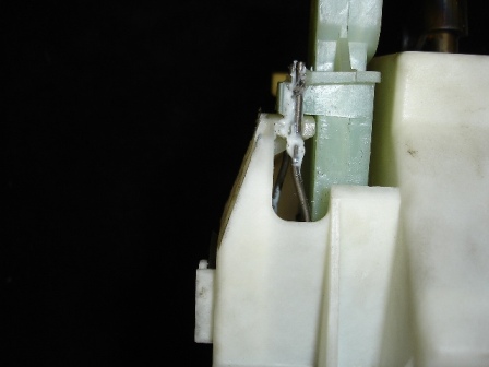

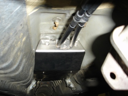

Attach cables to shifter, then attach shifter to mount w/ provided hardware
Cable cover plate
Attached cable cover plate

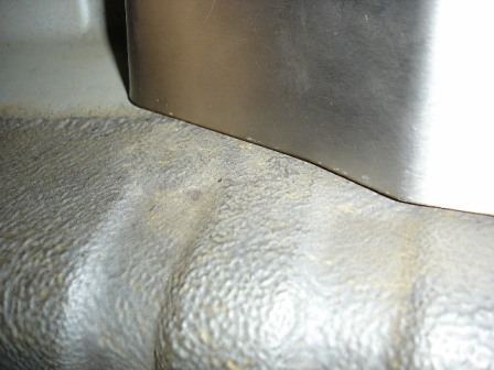

Damn, that's tight!
Like a glove...

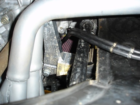

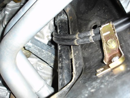

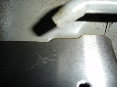

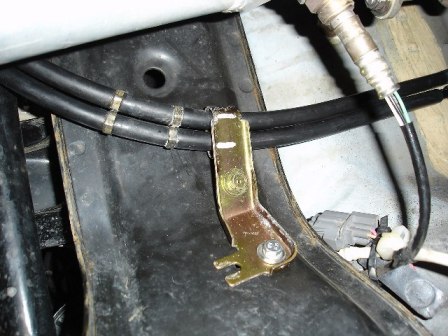

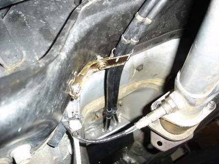

Cable mounting bracket provided w/ rsx cables
You can pick up tapped holes in the bottom of the EG/DC crossmembers to mount the cable bracket (w/ EK crossmember, you will route cables above crossmember and not need anything but maybe a few tie wraps)
It's like Honda planned the cable routing this way.
Tons of clearance...
Finished product

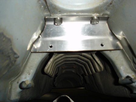

Rear mount

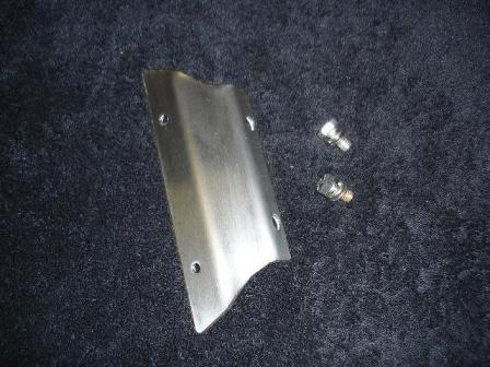

Cable cover plate

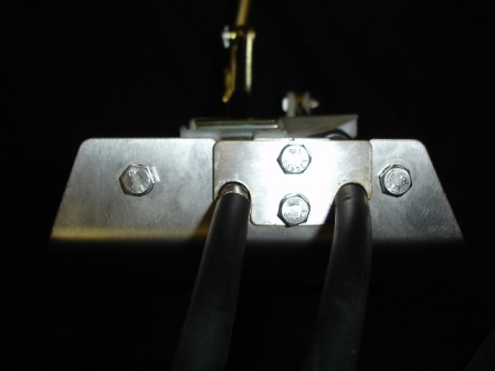

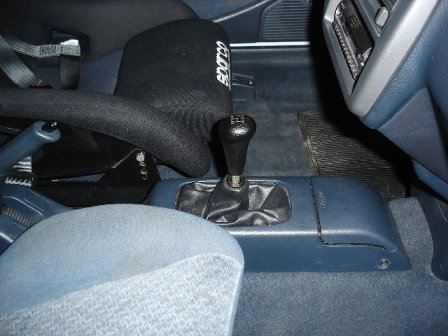

Finished product
