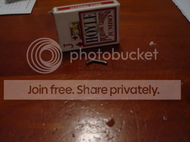

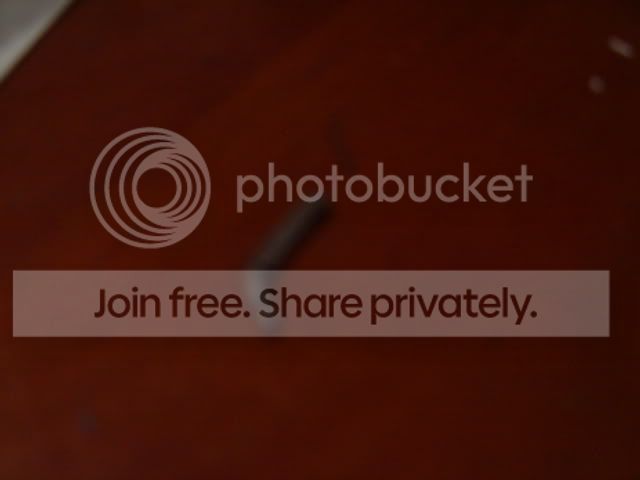

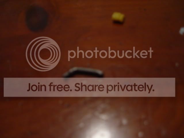

ok so i have a built b16 turbo and i have had no problems out of it runs fine, just leaks a little oil out of the return bung on the oil pan, so today i drop the oil, and oil pan and i find this in my oil pan

looks Like a Oil injecter found in B Series Vtec blocks
Do you have after market pistons?

thats an oil squirter,drop the oil pan and you will see it broken,its located at the botton of the sleeve,easy to replace
