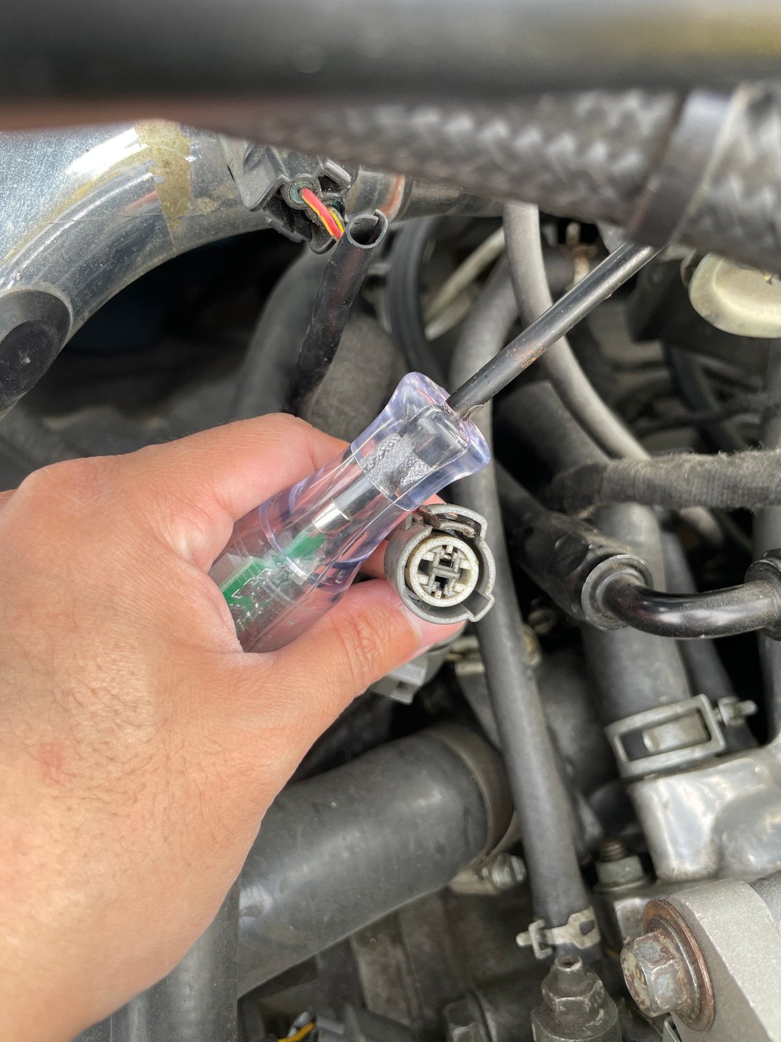

Old May 3, 2026 | 07:42 AM
Sipoon's Avatar
Joined: Apr 2026
Posts: 4
Default Re: B16a 1989
Do you think this is the modern socket of thermo switch? I just found it i think?
Old May 3, 2026 | 07:51 PM
JRCivic1's Avatar
10 Year Member
Community Builder
Active Streak: 60 Days
Joined: Jan 2013
Posts: 10,060
Likes: 1,248
If it has a green wire and a black wire... then yes.
