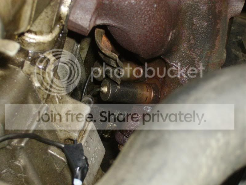

im having trouble with my 02 censors.
the engine light comes on and i can feel the engine bogging down while im driving.
ok here goes this is my o2 censor setup on my 90 ls engine in an SI,
both of my o2 censors are single wire, dont know if some come with dual wires.

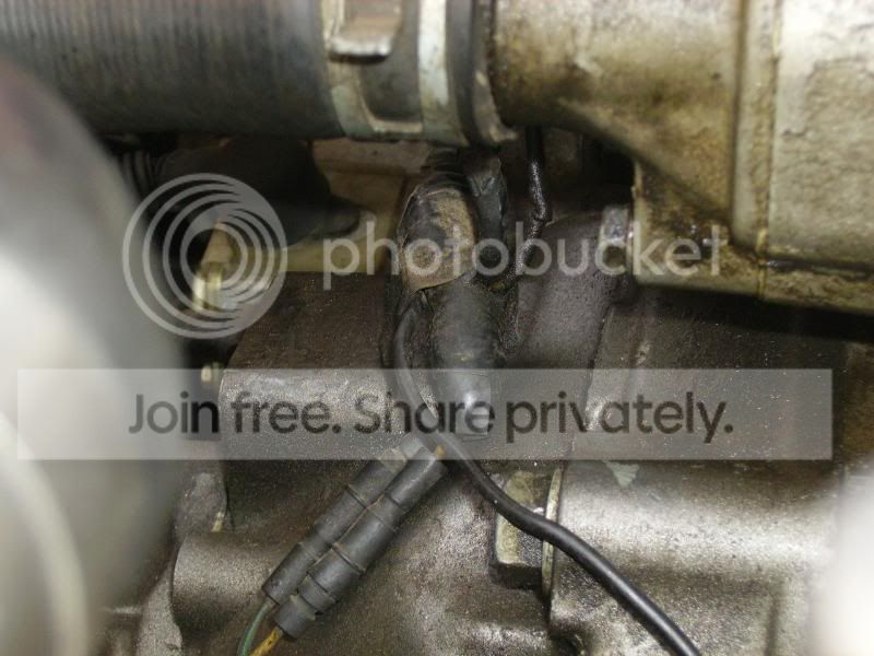

Both of the censor wires are connected together, then another wire is connected to both of those wich is connected to my SI harness.
does this make any sense to anyone and is there a better way for this connection
to happen?
but my main concern is, it giving me the engine code because of the way it is wired
or because the censors are just bad..
could the 2 censors be in some way canceling one another out?
for sure im gonna replace the censors but i would like some help on this befor i go and disconnect anything.

the header that is on the engine has 2 sensors.. should it have only 1?
should i replace only 1 then? which one?

ok so i disconnected one wire but and just left one sensor connected, but i didnt remove the other one.
i went for a drive and the check engine light came on again , damn.
2 marrow i will connect the other one and test drive with that one connected, and see what happens.

here is proof that i have 2 sensors and how there connectd. my pm6 ecu . now my ecu is thowing a code , is a code 13

ok from all the info everone has povided i finally brought myself to think of a few things i hadnt before ...
1. i most likely have the wrong headers wich have 2 sensors.
2. i have the wrong ecu.. in need of obd0 pr4.
but i dont see how having the wrong ecu would give m a code 1.
now if i do need the 2 sens. im gonna ask
traxxasx to do a write with details on that..

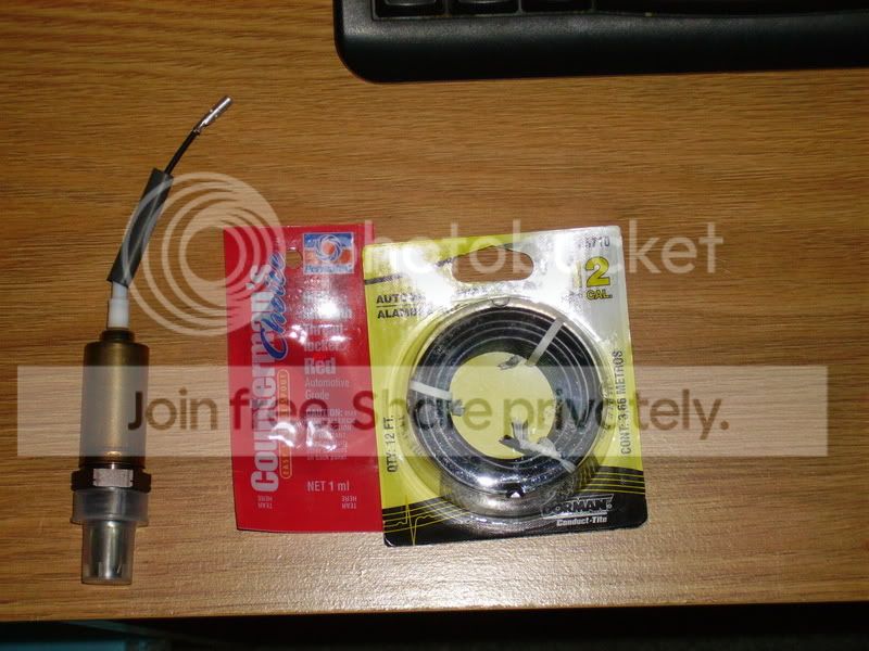

so i went to schucks and picked a uni. sensor.
and installed it.
supplies
installed and soldered some xtra 12 gauge to it.
connected to harness
Old 11-03-2008, 01:24 PM
85crx509's Avatar
Join Date: May 2008
Location: u know where, wa
Posts: 64
ok after all the work im still getting code 1
