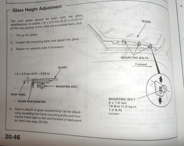

From the 1995 Service Manual:
I checked the 1993 manual and its instructions are the same as the 1992. However, on my 1993 Si, the mounting is the same as given in the 1995 manual. So, either my sunroof has been replaced (unlikely but possible) or the manual is wrong (also unlikely, but possible). Guess I'll keep an eye out for 93 Civics at the yards and verify how their sunroofs are mounted.
Good to know. Seems like the adjustment procedure was simplified after 1992 but was recomplicated (shims) for 6th generation Civics.
Thanks for this! I need to do this on my '94, but all I could find was the '92 pages w/ special washer...
FYI - my '94 Si is as pictured above.
