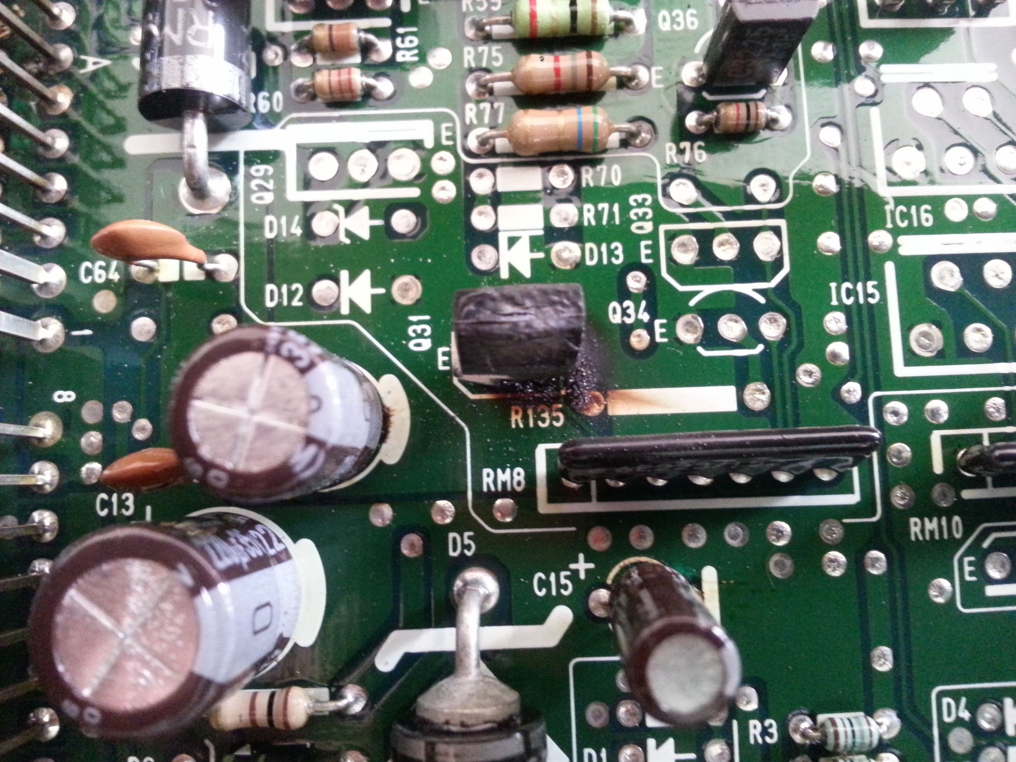

i had a crank intermittent start issue as the fuel pump was not getting juice all the time...i have a good relay... when i pulled the ecu i found a fried circuit...i am having a hard time finding a 37820-P30-A00 and was wondering what my options are, i want to keep it stock...
