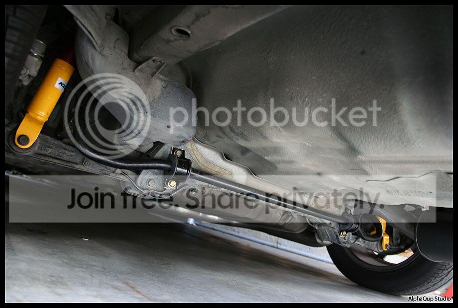

Look what I installed this morning:

Sweet! How do you like it? I still have my GC/Koni Yellows, ASR Subfram/Swaybar in their boxes.

I love it man. I've had my koni/GC's on for about 3 months now but, the 23mm j@YD33m ITR sway bar feels really firm around the corners. The rear feels so much more solid now as well since the flimsy LS bar is in the trash now.
I've got some OEM end links FS if anyone is interested.

Are you going to run any reinforcement? My friend tore his subframe from just a 19mm swaybar.

Yeah man, you should look into a subframe brace of some sort. I've heard of subframe tearout a few times.

Hey alpha R-Crew is in the bay area and my friend runs their Subframe Brace on his racecar, works great... might want to hit them up

Guys... haha I'm not that stupid. I'm frugal you see. I am running the BSQ kit. That's what I ran on my DB8 when I had it and everything was gravy running my ride hard for 2 years, no tear out. Although a nice looking brace would be nice, I opted not to since the BSQ kit serves the same purpose. Did I mention it only cost 24 bucks?
Here's the link to BSQ's site for those who didn't know:
http://geocities.com/bretq/swaybar_install.html

damn I totally missed it, I was looking closely too

Yeah ive heard of that kit before... **** for $24 id take it any day!

I had the BSQ kit on my car for about 7 years (met him when he first came up with the idea), but all with high spring rates and never had any tear out. If your suspension is stiff enough, then you probably won't have any problems, but if not, you'll likely mess up the subframe. I've seen a number of them bend and tear out. The DB subframe is a bit beefier than the DC's so it's much less of an issue on them. It's worth the extra money for something stronger.
I now have an ASR brace on mine even though my susp has gotten much stiffer. Just feel better about it, given the cars age.

Not that I'm doubting you, but where did you get that the DB subframe is beefier than DC's? When I was under there, it looked identical to me. In fact my DB didn't even have as good of a setup as my DC. It had OTS Civic GC's with Illuminas, and they were not stiff at all. Like I said before, I rode fine for 2 yrs, no tear out. Stronger is always better, no doubt about it. Why disregard the BSQ kit when it's tried and proven (from personal experience)?
Now if my car was a track *****, I'd definitely get the extra reassurance of a beefy subframe brace.

A number of people I've talked to who race DBs competitively have told me they were beefier. Don't actually know myself other than that.
I'm definitely not disregarding it. Like I said, I used it for about 7 years with no issues whatsoever and couldn't have been happier with it. But this is a part of the car that is very prone to metal fatigue with age and a number of my friends have had theirs tear out, crack, or bend (especially recently and both street and track driven) with the BSQ and other kits. Given the age of the car, its only a matter of time. I'm not saying you should get rid of the BSQ for an ASR/Comptech or anything, but you may want to seriously consider it again. $160 is a lot better than the $400+ it'll cost to replace the subframe.

Thanks for lookin out Erik. I'm cool though. I'll just keep an eye out for any noticeable signs of stress on the subframe from time to time.
**EDIT**
I forgot to ask you... what type of cars were your friends driving, who had the ripped out subframes from using the BSQ kits?
