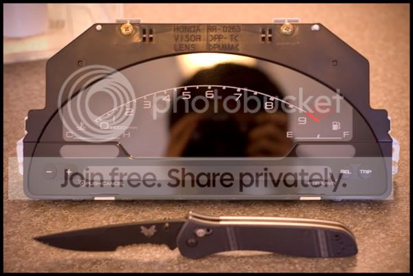

Originally Posted by HOTSAUCE01
I really want one of those s2k clusters
I have one
Ready to go in for the mockup of the CF bezel whenever I get back home. At the stage in my build where I have the whole car + engine harness ripped out for paint anyways.

I have one
Nice Benchmade!
