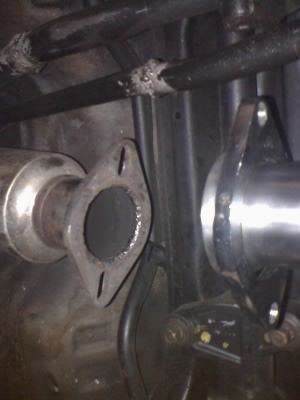

Did the RMF replica header install today. It barely clears the radiator fan(slim fan) and the a/c lines, but it does. Thank God. I had to trim the **** out of my cross member. If you EF guys are putting this in your EF be prepared to cut the ever loving **** out of your crossmember or buy an aftermarket one. Soon, I am going to just hack the entire center section of this crossmember, weld some supports inside the open ends near the radius rod mounts, and then weld a strong bar in between to make my own "aftermarket crossmember. This header is also about 6-8" shorter than my DC 4-2-1, so I've got to run it to a muffler shop in the morning to get that closed up. I would do it myself, but I'm tired of being on my back on the ground. Here are some pics.
I should have really taken the crossmember back off and ginded another 1/4" on the bottom and top parts, but I was tired and fed up. I'll get it another day. hopefully I mod this crossmember before I get around to doing that. What a PITA.

That cross member looks scary.
