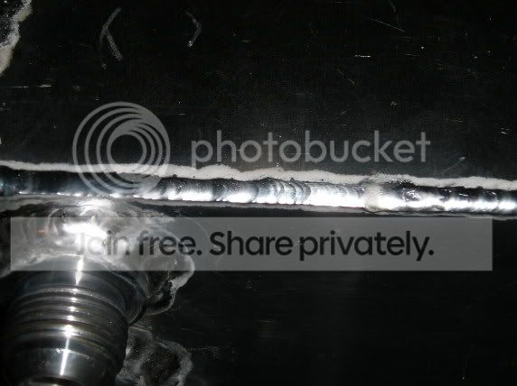

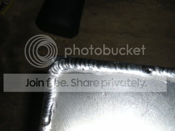

Mine is not as pretty as Tonys, but it is 100% functional and has been pressure tested and leak checked to 25psi. I did the leak check with just soapy water....
And a close up of my welds.... like I said not as pretty as Tonys

Tepid, is that the finished product?

<TABLE WIDTH="90%" CELLSPACING=0 CELLPADDING=0 ALIGN=CENTER><TR><TD>Quote, originally posted by tepid1 &raquo;</TD></TR><TR><TD CLASS="quote">Mine is not as pretty as Tonys, but it is 100% functional and has been pressure tested and leak checked to 25psi. I did the leak check with just soapy water....
</TD></TR></TABLE>I think you're missing those filters on top? or maybe it's not finished yet? Looks good.

Default Re: (tony1)
Nope.... I need the filters still.

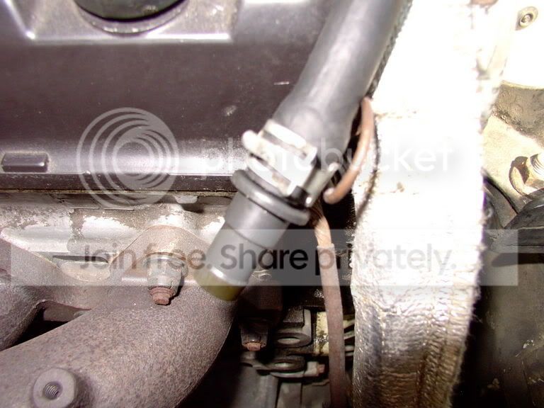

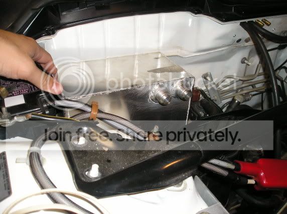

Here's something I fabbed myself. 2.5" Aluminum pipe baffled with drain, 3 inlets(one from black box, one from valve cover to right side of can, around baffle then out to pre turbo. I plugged the PCV valve with JB weld to avoid leakage. I also added some steel wool in the bottom of the can to aid in filteration.
The tube resting on the valve cover goes to the black box.
All hooked up.
