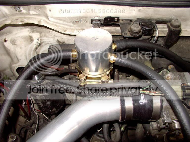

sorry tony.i liked yours so much,i had to make one for a freinds car.gonna make one for mine too

So the 2 on the bottom of this setup^^^ are just used for drain back into the back of the block correct? Where the allen head screws were.

<TABLE WIDTH="90%" CELLSPACING=0 CELLPADDING=0 ALIGN=CENTER><TR><TD>Quote, originally posted by turbotypeR &raquo;</TD></TR><TR><TD CLASS="quote">sorry tony.i liked yours so much,i had to make one for a freinds car.gonna make one for mine too
</TD></TR></TABLE>what size are the lines and fittings on the valve cover are they 12...looking good by the way

Default Re: Whose catch can do you use? (turboedc2)
they are 12 on the valve cover and 10 on the back of the block.i took and welded -10 fittings on the honda fittings

can anyone recommend a location other than the battery location for a custom breather tank like the one in the above picture in a 96-00 civic?
