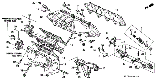

hi little question do's anyone now where i can order bigger seals for my edelbrock victor x?

yes this are the oem seals from gsr engine but are to small ..

I believe there are 2 different types of seals, what year was the gsr?
I believe OBD2 seals are different then OBD1 seals. OBD1 should be the ones you want . At least I know this was how it was with my d series

Curious what brand injectors you will use?
This isn't as easy as it looks sometimes....I noticed my ID725's were a very sloppy fit (ITR intake)..I ordered every "cushion" and "seal" I could find, and ended up making some nylon flat washer type units to keep the injector from unevenly distorting the seals when rail was tightened.
My **** is kind of thrown together, but I wonder how many people have boost leaks there, cuz it was hard to get right in my case.
It is now, but took some doing. Honda shows two parts in the bore, I don't remember how it looked when we had a GSR.
this is for a 94.
I ordered #4 also and its a thin little ****.
The bores under your seals look rough, btw...what do they look like with nothing in there?
