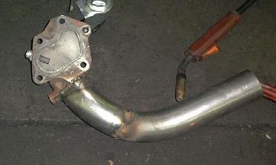

I used the stock downpipe/"O2 housing"
. I basically cut it in half, and welded a 2.25" 90 degree bend to the cast iron piece. Then, I simply used a 1.5 foot long 2.25" pipe to mate it up to the exhaust. It basically looks like a stock setup.
I got these pics from HMT
Maybe they will help to explain what I am saying.
I have been thinking of upgrading to a 2.5" downpipe for a while (or maybe even 3"?) But I am worried this will just increase the problem.
