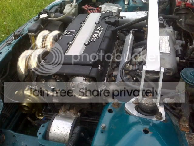

I have been reading around on the net for a while trying to find an ok way to "street tune" my vafc to increase fuel so that I can be semi safe driving around town on 8-10psi untill i can purchase hondata and get to the dyno. The Term I've seen being used is " Vafc Hack " and with the Vafc people have seem to tune there setups this way untill they can afford or get to the dyno for a Real tune.
I see that people have done this before, Im just not understanding what settings to go into to increase fuel. Has anyone done this before or know how? Thanks for the help..

All Im looking for is some one that knows what settings would make the the ecu add more fuel to compensate for the boost

In all of these "hack reports" is say to put the fuel in the negitve to lean it out. I want to Inrich mine. Would this mean that I would have to put it in the + side to add fuel?

Well it boost fine till about 7psi or 6k rpms. This is where I think Im going to just leave it till I get the hondata. Any thing over those numbers and it starts poping like as if its missfiring. But if I dont put my foot in itm it's fine, So I think this is were Im going to just leave it till I get the better management. I have a DSM friend of mine that is going to look for some Blue Tops for me and I have a resitor box from an OBD0 B16. So untill then i guess, Thanks for your help everyone. I will update as soon as i get the rest

Put the Vtec Vales at -40 across the board, for this hack to work as intended you NEED 450cc injectors. nothing else will work well other than a Real management and any size injector. Tune it +- from the starting point of -40. What this does is lean out the largers injectors therby shifting the entire Map down a few ijnector pulses making it run normal on larger injectors and giving your map sensor enough room for max 11 psi. I did my setups like this all the time and never had issues other than retarded timing maps since the shift also skews the timing maps....
In short if its all you have right now follow these directions and you'll be fine until you get to a tunor or gaydata

Well yesterday I made a post about the vafc hack, And with all the help on here plus with the help a google lol I managed to get my car to boost till 7psi fine with the stock injectors. Anything over 7psi and that car would start to pop real bad, Alot of you told me that for this to work I would need larger injectors. Well I made some calls last night and I managed to pick up a set of 450cc blue tops.
So this is were I start today, 450 blue tops + Vafc. I also have some of the self FMU but I think all that is going to be used for is a paper weight lol. As soon as I get the 450's installed I'll update some more.
