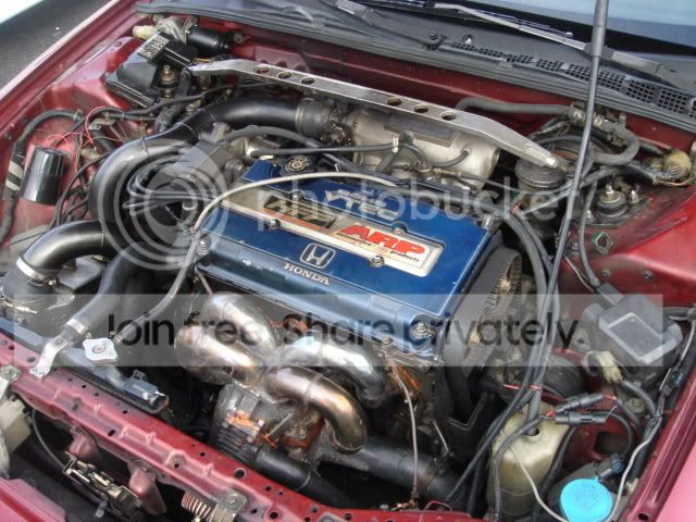

Just so your not alone in your thoughts, this was at out spring honda-tech meet.
Old Jun 4, 2007 | 01:52 AM
SD_Lurker's Avatar
HT White Ops
iTrader: (4)
Posts: 6,116
From: Ova Thur, United States
Default Re: (a1320honda)
^^wow all that work to go turbo and they didn't even feel the need to get gaskets. HMT at its best right there. That thing is hideous.
