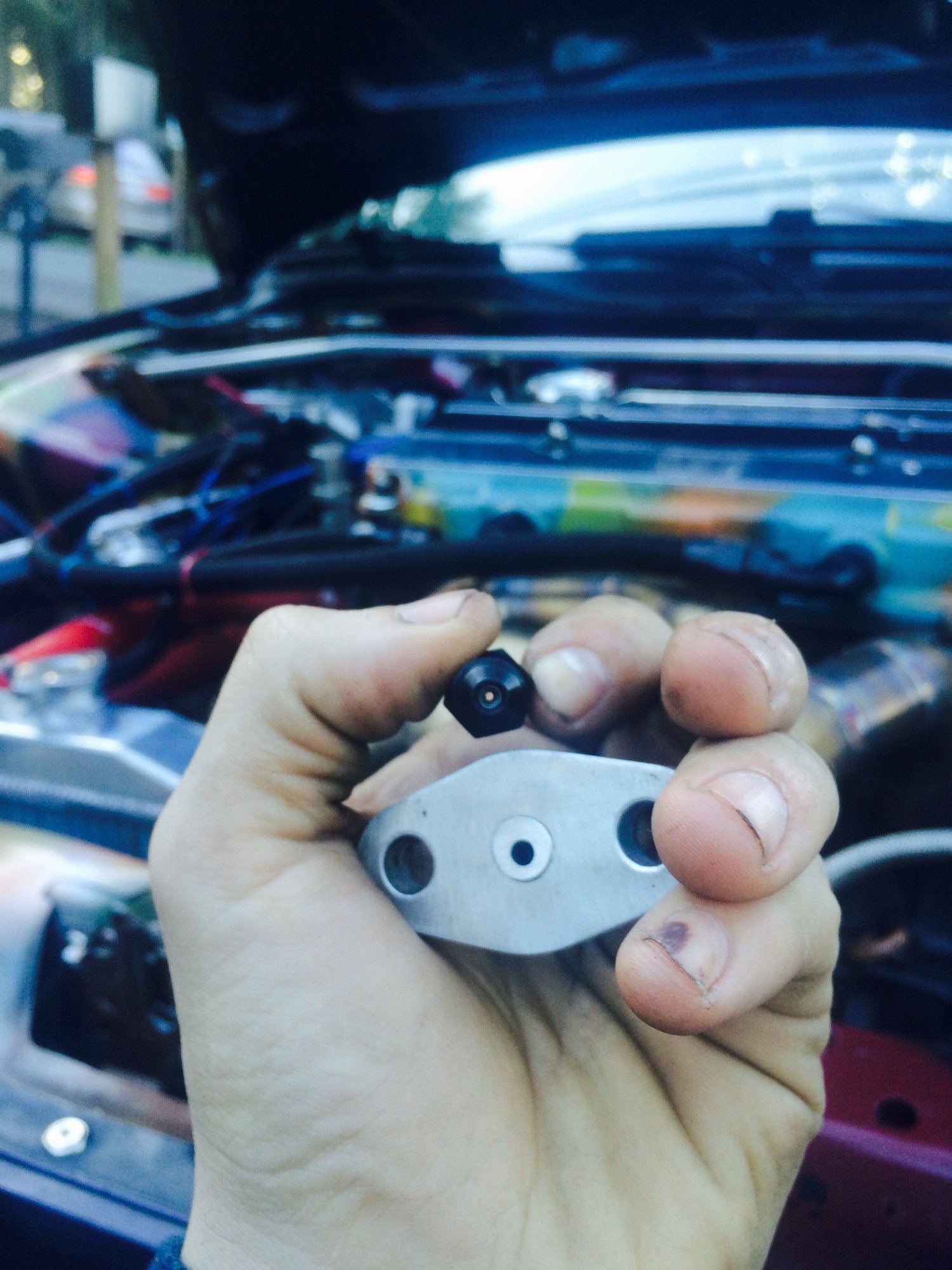

Yes, Shodan helped me out a lot. "he" would be the Tunner and he didn't have the -4 feed line restrictor so I went to speedfactory and got one from them. Also got Bred Penn oil 10w40 and will see if it helps a lot. Here's the pic of my previes adaptor And new restrictor.
Big difference, new one is .65

So I installed the restrictor and changed my oil and everything is fine now. No more oil clouds behind me, and doesn't even show any blue smoke at idle. Thanks Shodan!!!!

I sure did save that turbo thanks to you Shodan for your good eye!!
The car runs much smoother now and the oil presure gage actually functioning normally now.
Also, should I be worried about oil starvation to the turbo? The .65 hole does look small

Oil pressure pushes through the restricter to feed the proper amount of oil to the turbo. No worries unless you oil starve the whole engine
