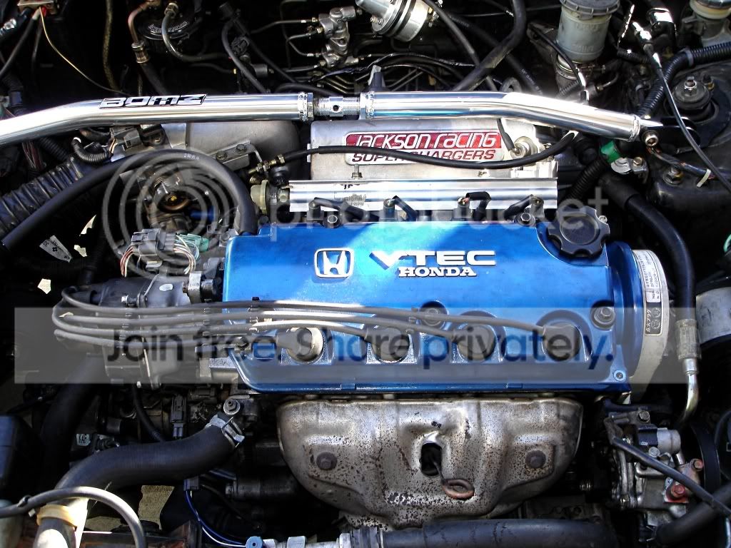

BTW here's a pic of my installed JRSC...

nice **** what kind of numbers are makeing and what type of mangment? that big round thing is the jrsc fuel presure reg? j.w? **** looks like it rips the tires rite off...

thats a rising rate FPR increases pressure as boost increases.
It's running on the JR FMU right now. It's also not that fast but I'm still in the process of modding it. Currently looking for A DC Header, 460cc injectors are on the way, custom intake tube on the way, I'll be running 2.5" exhaust piping, 24" resonator, magnaflow muffler, and a K&N stock replacement Air Filter. Then I'll get it dyno tuned and post up the results.
Those day I'm trying to install JRSC kit on my EG, same setup as NeonPinHead.
No matter how much I'm trying, I can't get connectors from the main wire harness to place. eg. fuel injector wires, air sensor at the back of the JRSC ans so on.
They are just too short, or maybe there is a way to orginize them so it will fit the SC?
There is a need to make the wires longer by welding, or any other modifications?
I've tried to orginize the wires as it written on the JRSC instructions, but it doesn't work.
NeonPinHead can you please send me more pictures of your installed JRSC? Maybe someone else?

i dont have a pic of it on my pc at the moment might need to take one for you tomorrow. but what i did was i took the harness an ran it above the water pipe on the back of the block. i also re moved that plastic bit around the injector wires.
needed to solder(not weld) a longer wire into the air temp sensor. about 6cm or so.
best i can do for now. put red(harness) where green is water pipe. hope you come right once you have done that.

Originally Posted by acura_el2000
wait.. what?? pics please!!!
These picture of the old setup. (warning maybe a little rough for eyes)
http://s3.amazonaws.com/ephotospace/209418.jpg
http://s3.amazonaws.com/ephotospace/209419.jpg
http://s3.amazonaws.com/ephotospace/209417.jpg
http://s3.amazonaws.com/ephotospace/209611.jpg
http://s3.amazonaws.com/ephotospace/209610.jpg
http://s3.amazonaws.com/ephotospace/209608.jpg
http://s3.amazonaws.com/ephotospace/209607.jpg
http://s3.amazonaws.com/ephotospace/209606.jpg
I will DL my latest picts and possibly vids sometime when I have it all back together with a he351ve strapped on top of it.(late March most likely)
