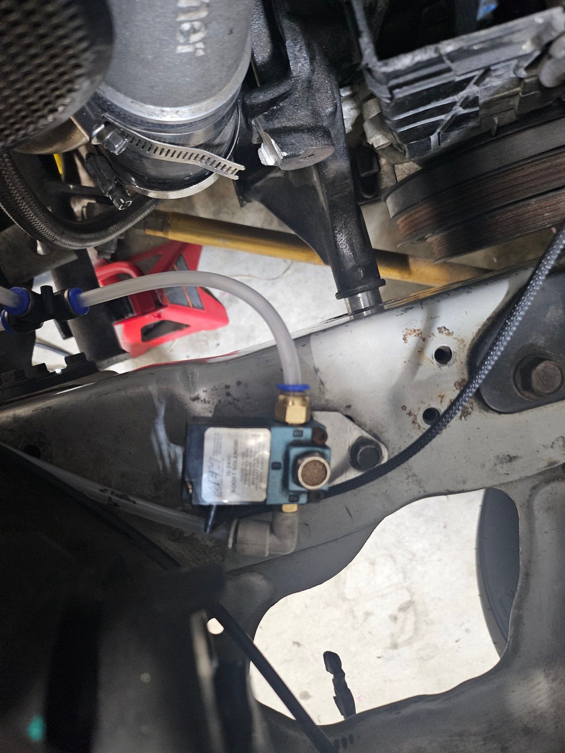

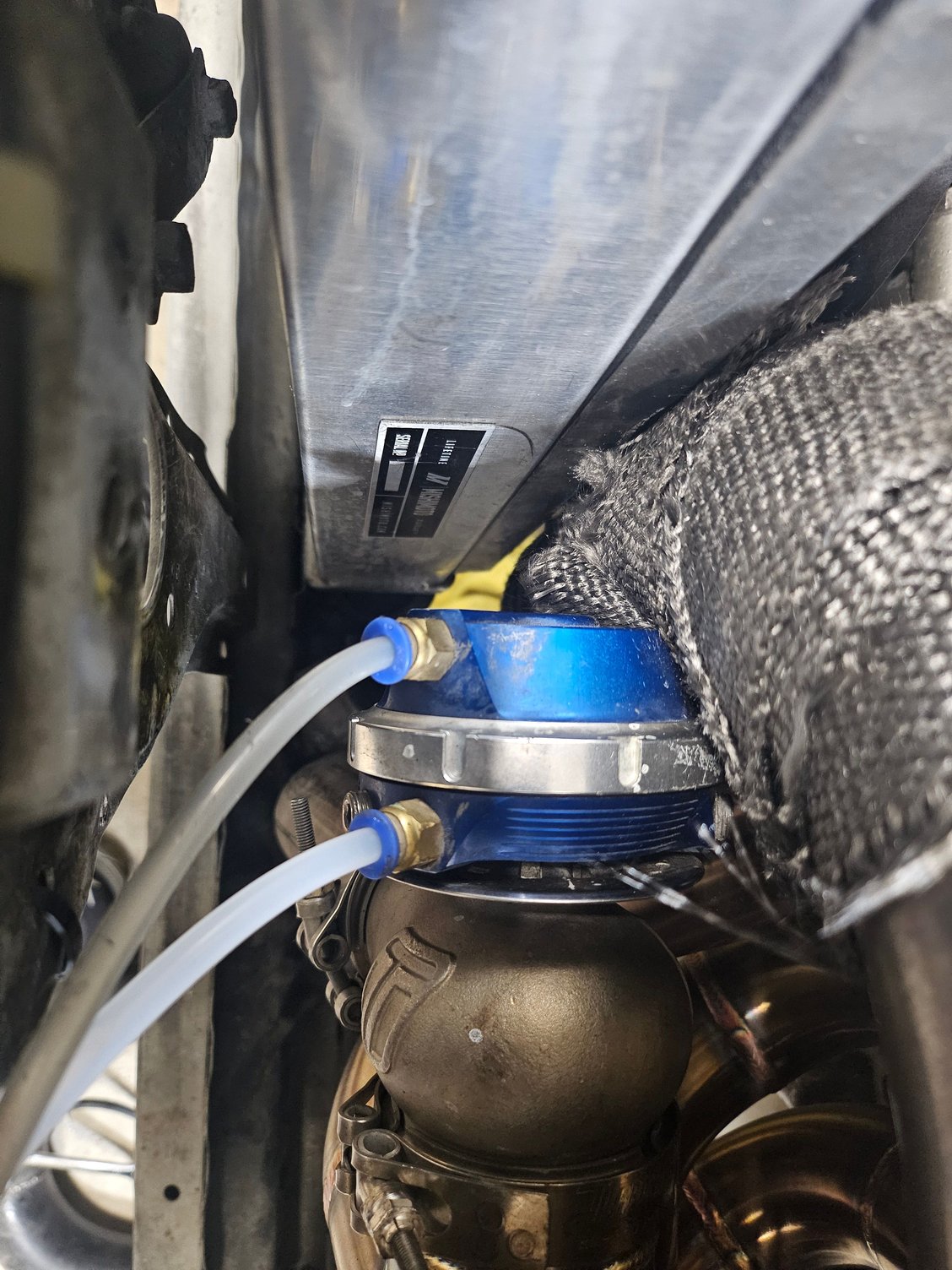

I replaced vacumn lines however after replaced car spluttering high rpm not building boost. Did i connect correctly? Port 1 right side turbo and bottom port waste gate and port 2 left side goes top port waste gate. I have turbosmart wastegate and aem boost solonoid.

You have a vacuum leak somewhere
