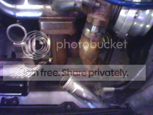

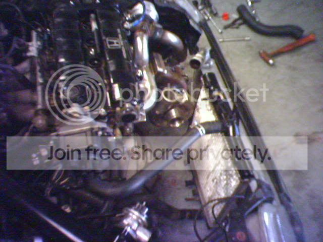

This was done on 93 octane pump gas with a stock motor. My tuner and I were talking one night and figured that the compression on the zc is lower then the b16 and Gsr motors so we figured we could tune the motor to 15lbs with a real solid tune. We ended up upping the boost from 10lbs were I made 238whp and 181wtq to 15lbs where I made 278whp and 230wtq. These number are from a dynojet machine. By looking at the graph the power improved everywhere. By 6k I had made a 60whp gain!! Once again I would like to say tuning is key! O yea im running a Td06 17c turbo. My A/F is 11.8-11.5 through out the band.Setup was tuned on Crome pro by Huy Tran of Inline Racing here in Houston, Texas.

Yea mine is coverted to true obd1 from dizzy back. I never had blow by with my motor. Im running a log manifold, td06 17c turbo, 35mm tial, 3inch side exit down pipe.
