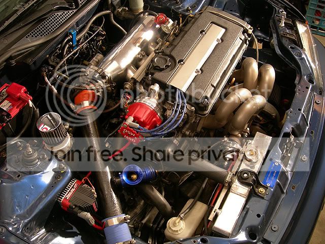

so i guess i CAN use the MSD blaster SS coil instead of the SC? I see it installed in the engine bay of tonys car but i noticed on the summit site that the SS coil has male/HEI connections and the SC coil comes with female connections. so would this be a problem?? and also is the msd wire harness for the distrubtor PN#8864? and dose the dissy come with a rotor or do i have to order it too?? just making sure.

all you have to order is the dizzy and the ignitor since you already have a coil. you can also order the msd wires for the dizzy becuase they have the ends on them your going to need to connect them to the cap. the msd ignitors are back ordered. i have an extra one if someone needs it. this in the package, brand new and unopened

New connectors are sent with the distributor, so all you have to do is cut the ends off your current plug wires and put the new ones on.

MSD says you are supposed to use the new SC coil with it... but tony is using the SS and says its fine... so they prolly just say that so you have to spend more money.
I just bought all new stuff instead of reusing my old coil.

They redesigned the ss coil to be able to screw together with the coil driver that goes with the MSD dizzy. The only difference was the outer casing. BTW I'm very happy w/ mine

The SS and SC coil just have different style terminals... Anyway, the MSD setup has been running on my car for 2 months daily driven 5 times a week. So far so good, and the engine doesn't even hiccup a bit with my spark plug gap out of whack + water injection. The car also picked up 40 km per tank of gas, so maybe about 2-3 years later down the road the gas savings would pay for the MSD unit itself
