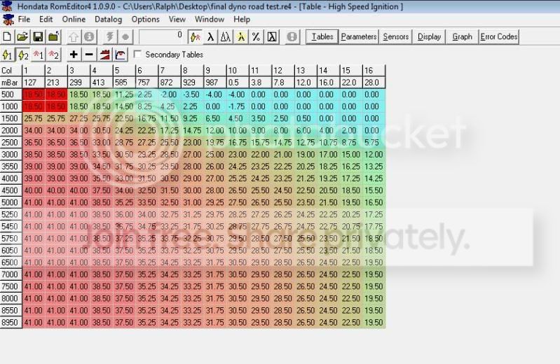

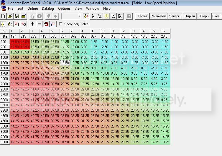

here are your ign tables...i got it from the file you attached above.
ok here's what i think
the 30deg base ign timing is possible. WHY? because maybe you are idling a bit high, maybe 1000+ rpm and engine is cold. the ign during that stage is a bit high. anyway during data log, you will see ign is at that range. 25-30.
so given the benifit of the doubt ur tuner syncs ign map,
how much compression do you have? probably 9-10:1 right?
your ign timing is way too high for a 93 octane. i'll never tune this aggressive. moreso, maybe you have bad IATs.

15 degrees of timing at 28psi on pump is crazy aggressive. then again i am use to small bore 75mm d series but i cant imagine 13 degrees of advance on pump at 28psi
your lookin at the low cam dawg,
the high cam has 20* advance at 28 psi,
oh billy!!!
did no one hear the detonation??

20deg @ 12psi doesn't frighten me much, I run that at 21psi... then again, I run 50/50 meth injection, and it's 9.5:1 so im not sure what to think.

ah ****, didnt know you were running a non-vtec,
but 20 degrees at 12 psi is still quite a bit for pump gas,
but if he didnt sync the dizzy with the software, and the dizzy was actually at 30 degree's, you can add,
30 - 16 = 14
14 + 20 = 34* at 20 psi
which is extreme,
and also not to mention, did he disable stock ignition corrections?
