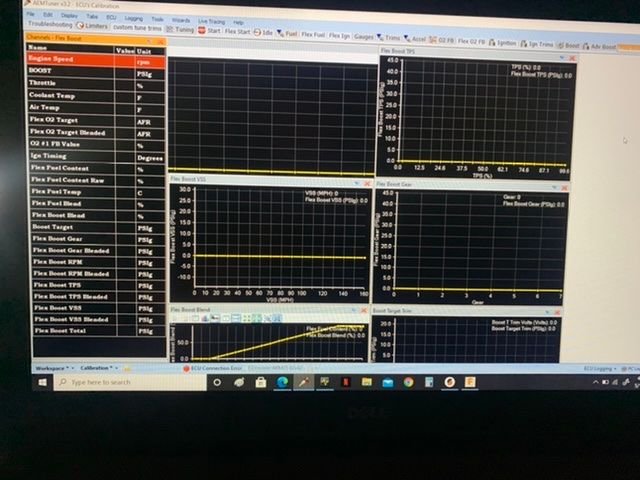

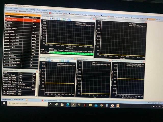

I want to upgrade to an infinity but currently on the aem v2. I love the v2 and have no issues with it. I can have my idle anywhere i want it very easily with old rc1000 injectors.
Heres the options for boost control on the v2.

I havent set up all my tables yet and just use the main table. Once i get on a dyno ill be able to play with the boost target comp and error duty to really dial it in and get the wastegate doing exactly what i want

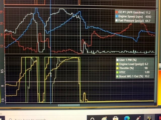

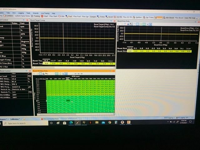

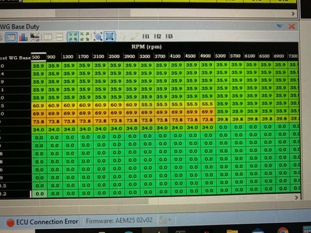

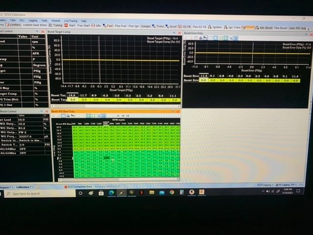

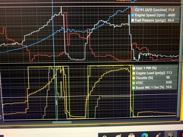

I only had a chance to try one setting yesterday. But here are two shots of my boost controller map.
What im doing is keeping the gate closed and trying to slowly taper to my target which is 13psi at 35.9 in the map.
My logs show me overshooting the 13psi target hitting my boost cut and going back up. Ive attached a log with just one setting of 35 and youll see the difference in spool up at the same rpm. 6psi at 4500 vs 11psi.
Once i populate this table with all the values at certain rpm ill be able to transfer that into the boost target comp tables then boost error tables. From there i can play with boost by vss, gear, rpm and tps postion.
