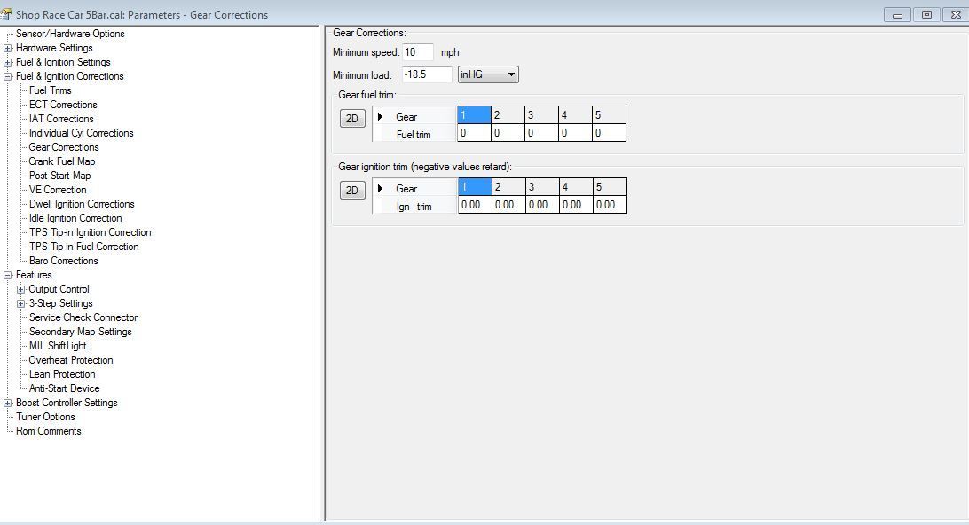

Can I interject a noobie question on EBCs here? I'm going to anyways, if it gets skipped over, so be it.
I want to run an EBC with my Neptune so that I can switch between tunes for the street and track. What EBC would you suggest? Also, I want to go from somewhere around ~8 PSI up to 15 or so. What spring should I use in my Tial Wastegate? Does it even matter since I am using the EBC? Just lower than my minimum PSI or exactly the lowest PSI I want to run?
Never really planned to run different PSI between daily and the track. But if it's not too difficult, I wouldn't mind toning it down a little bit. Plus tunerview makes switching a breeze.
Thanks.
Old Jul 17, 2014 | 06:14 AM
  #39
TheShodan's Avatar
Moderator
iTrader: (14)
Joined: Jan 2002
Posts: 24,555
Likes: 242
From: City of Wind, IL, USA
Default Re: Let's talk electronic boost controllers
Thanks.
The question really revolves around your use and purpose, as well as preference.
If you want to integrate Neptune and Tunerview within the laptop system, from what I understand, its similar to both Hondata S300 and AEM EMS in which you would utilize a solenoid that will have a 5.4v signal. This means you have your choice of the MAC solenoids from the various companies, Chrysler & GM solenoids (with a couple of small adjustments)
"Switching" is a breeze either way with either an electronic or dual manual controller, so it doesn't matter whether you use a manual or EBC to perform what you need, as a competent tuner can use Neptune for both types.
But, if you do stay EBC, based upon what voltage the Neptune integrates with, it does matter which solenoid you use. (Be it MAC or Chrysler/GM). You just need to know the boost pressure change-over point (that your tuner will establish) between the two fuels. Its really that simple.
Now, as for the spring of the wastegate, and what size to use, this really depends upon what size turbo you have in relation to the size wastegate you plan to use. Simply stating that you "want to go from somewhere around ~8 PSI up to 15 or so" really depends upon the turbocharger you're using.
I've always found that even if the solenoid that you use has the capability to allow a broad range, doesn't mean its best to try and stress it to their limits. (As an example, attempting to use a 4psi spring in the wastegate itself to control 4psi up to 25psi because you want to use the Boost-By-Gear option.... It can be done, but really shouldn't as boost pressure stability doesn't hold as well because you're using such a high percentage duty cycle to try and maintain it.)
In your case Freemananana, I'd look to the keeping the spring reasonable like about a .4bar spring if using a TiAL or the 7psi spring if using a Turbosmart wastegate of similar size. But in order to be more accurate of where your best boost pressure range efficiencies are, we need to know (generally) what size turbocharger you're using.
I hope that clears it up a little.

It's starting to. Just a quick rundown of the basics, to give you an idea:
Neptune RTP
Log manifold
Garret T3/T4 .57 trim 63 AR (Rated in the neighborhood of 400 HP tops)
Tial 38mm single wastegate
I believe it currently has the 'large yellow' spring, 0.7bar ~10PSI. Buying a new spring ($10) isn't a big deal. I was just going to get it tuned on wastegate pressure since I believe that will put me around 300wHP. I'd prefer to fall short than to overshoot it. It's just a simple set up and I drive the car to work daily.
Also, I wasn't planning on using multiple fuels. Just 93 octane but changing the boost pressure. The only reason I mentioned PSI was to give a numerical value to how big of a difference I would like the boost controller to make.
If this is something I can simply set up some other way, lay it on me. I don't really need boost by gear. I doubt the torque will come on abruptly enough to cause too many issues and I'm not pushing anywhere near the limits of FWD traction (from what I've read).
My only knowledge of boost controllers comes from reading about using internally gated turbos (small ones that come on factory cars) and upping the pressure via a boost controller.

Originally Posted by wfocrx
this is interesting because I was wanting to tame my turbo gsr crx on street tires/drag radials. I am wanting to get a dual stage controller and run like 5-6 psi in 1st/2nd gear and ~15psi in 3rd and 4th. I was wondering if I can retard timing like 2* per psi for the first 5 or 6 psi and than somehow get the timing to where it should be by 15psi?
You can go into gear tables and pull timing on a gear by gear basis. At least I can in ectune.
