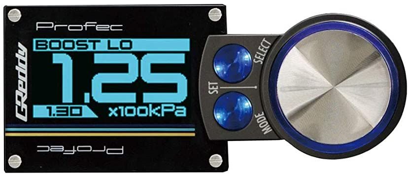

The newer Profec that was released a few years ago is actually quite nice!! Even has a logic feature that "learns" when the gain should be automatically set in..
Unboxing the GReddy Profec Boost Controller
Never heard of that Haltech model. Does Haltech have rolling anti-lag? Did you notice any gains power wise from just switching to a full standalone? I've heard people say going from Neptune or Crome or s300 to a full standalone the car made more power on the dyno and just drives better with nothing changed overall. The new profec does look interesting i'll have to do more research on it. A learning feature does sound pretty dope though.
