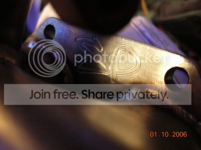

i still vote tubular log......look at this pretty one from SPoolin that i bought......
that's about the same price as the IP....but usually you can get them for like $300

I'd take the Inline Pro over a tubular log anyday. The tubular log (ie: above pic) flows like a Drag maniofld with 1-2 and 4-3 then into the turbo. The Inline Pro, although not equal length, still has all four runners collected into the turbo.
A SpoolinPerformance Quick4 Turbo Manifold would be more ideal if comparing to an inline Pro. That, I would have over the Inline Pro if similar priced
http://spoolinperformance.com/...2.jpg
