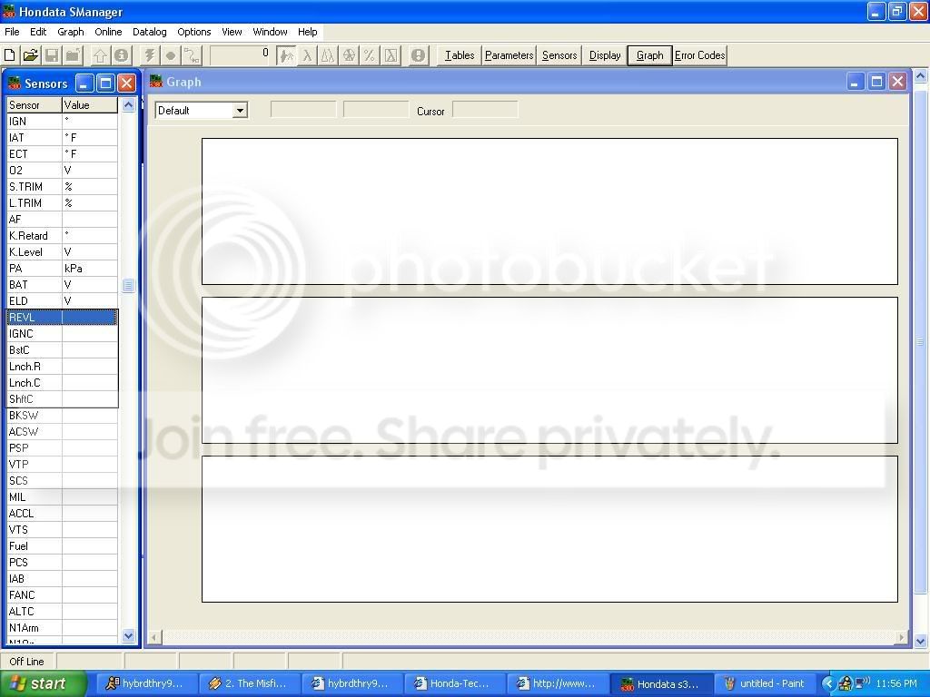

i have many datalogs. where does it say im rev limiting, boost cutting, fts?
Old May 30, 2007 | 07:59 PM
morgan@synapse motorsport's Avatar
Posts: 2,278
From: upstate, ny
Default Re: (mike93eh2)
<TABLE WIDTH="90%" CELLSPACING=0 CELLPADDING=0 ALIGN=CENTER><TR><TD>Quote, originally posted by mike93eh2 &raquo;</TD></TR><TR><TD CLASS="quote">
i have many datalogs. where does it say im rev limiting, boost cutting, fts?</TD></TR></TABLE>
check the status of each of the sensors when this stuff occurs.
heres where you can find them on the sensor list, so find on the graph where this occurs and it might show you which limiter is activated if it is indeed a limiter.

ahh i see. ill check that out, thanks.
