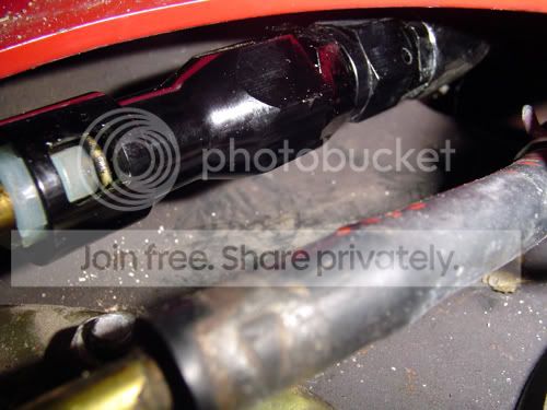

hey guys I got the fitting today, and guess what... it fits!!!!! i just havent had time to put my lines all together I need one more stupid fitting! but the fitting slides right on and locks like the oem one seems to do.
Old Dec 28, 2007 | 07:14 PM
  #29
Naudlee's Avatar
Posts: 1,781
From: s.shore, MA, USA

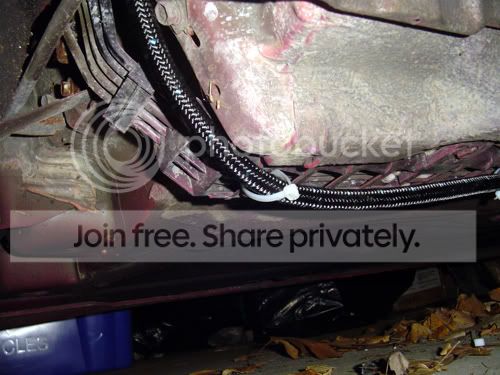

got it done, didnt end up needing the fitting I ordered, errgh i realized it after, o well, **** works!!!
heres the pics! I have saved any of you 96-00 civic owners a hassle, and now you can run nice braided line sof your choice and size from the tank! EASY!
used this aeromotive quick connect fitting, like the stock fuel quick connect our civics have...
http://www.jegs.com/webapp/wcs...75_-1
and some AN fittings off summit and some hose heres some pics...

Hell yeah man, thanks for trying that out. I remember the first time i saw that fitting it looked like it would work perfect. I will deffinatley be ordering one of those for my setup now, because that give me much more peace of mind than using worm clamps.
