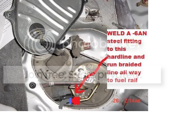

is it possible to weld a stainless AN fitting to the stock hardline coming from fuel pump cover like so in the pictures....
REASON WHY ASKING, im having serious problems getting my hardline to braided line setup to not leak.... have used fast-turbo compression fittin setup, swagelock double compression fitting setup, and the good old flare and tube nut.... i do not get why i still have serious leaks, plus I noticed my fuel feed hardline before it goes from bay to under the chassis is kinked somewhat.
anyone have any input, I have all the parts here and a buddy who welds like a champ, so why not?

I think you will find sticking a -6 on that metal line will be like throwing a hotdog down a hallway, I had issues like you and decided to just run fuel inection hose off the OEM metal and connect that to a barb fitting that converts to AN. I also cut the stock feed off and welded a -6 bung to there for the return.

I just used -6an Rubber fue line (like for the push-loc fittings, and just pushed it on as far as possible, and then used 2 small clamps, and it seems to be on there pretty tight.

i didnt think putting my braided -6AN line I have running to the fuel rail over the stock hardline (unflared, etc just straight line) was safe to clamp on there.... i mean it'll work, but I want something with no leaks and reliable

all a braided line is, is a rubber hose with wire braiding on it. the stock pump lines should have flares on the ends. putting hose clamps on it will work fine.

yes I know, but what I al left with is my stock hardline that came cutoff with no flares and a rubber hose clamped to it to my oem filter....
i have since got rid of that and ran braided nylon lines to an inline filter etc, but nothing is sealing correctly on the hardline to AN fitting conversion, so I dont think that clamping the braided line to the hardline with a couple screw clamps is safe for the 50-60psi of fuel pressure you think?

the clamp will work fine, but i know what you mean. you could always try welding a -6 fitting on and if it doesn't work just cut it off and use the hose idea. try welding one on a spare fuel unit if you can, just to practice. good luck

yeah, where im talking about clamping my hose onit is in the engine bay, not all the way at the tank where id be welding the AN fitting on and running braided all the way forward. Anyone have any more ideas/recommentdations/horror stories
