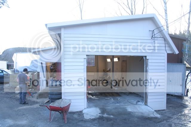

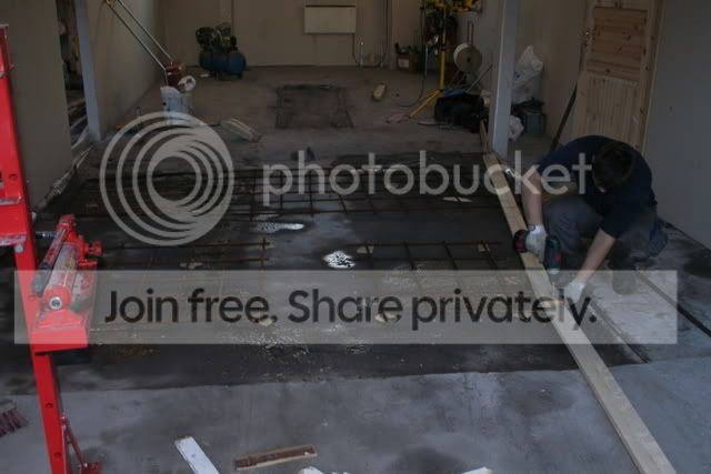

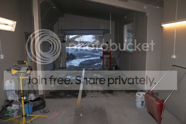

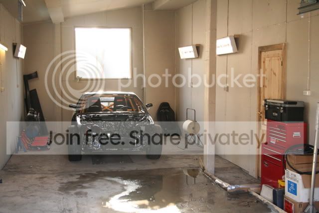

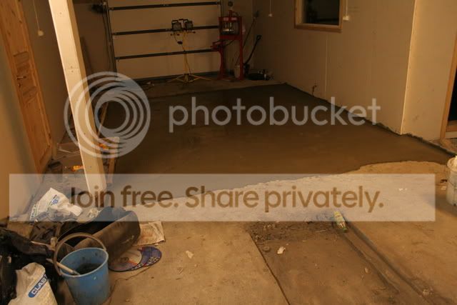

Here are some new updates.
Ive just moved in to a new workshop.
(We had to mold the floor becouse there was a 4" hole right when you pass the gate.
The water throwed on the molding after it dryed was stii left on the floor
The picture over and over again

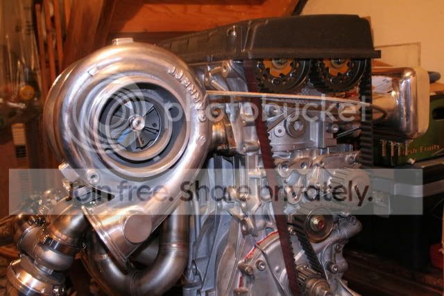

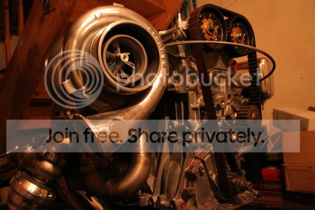

The famous v-tak line

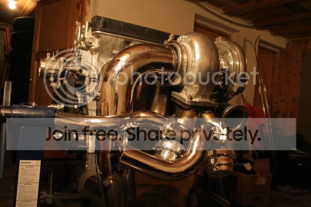

Cant live without V-tak haha. Probably the nicest crx builds i've ever seen. Looks like you've done your research as far as your set-up goes. I would like to see some testing between the 40r comp cover and the 42r cover. Thats the first time i've seen this, pretty interesting.
Old Mar 31, 2007 | 05:26 AM
  #80
atec's Avatar
Posts: 669
From: Norway
Default Re: Re: (SlowReaction)
as far as the testing goes I think it will end here.
I will use the new 74mm weel and the 40R housing wont fit unless I machine it out.
If I want to use both weels, I think I need to balance the shaft (with each weels on)
But, I will test how far I can stretch the engine

Actually I will go to a machine shop later this week to machine the compressorhousing to fit the 74mm weel.
It wil then be a gt40 w 74weel.
That will be intresting to try out.

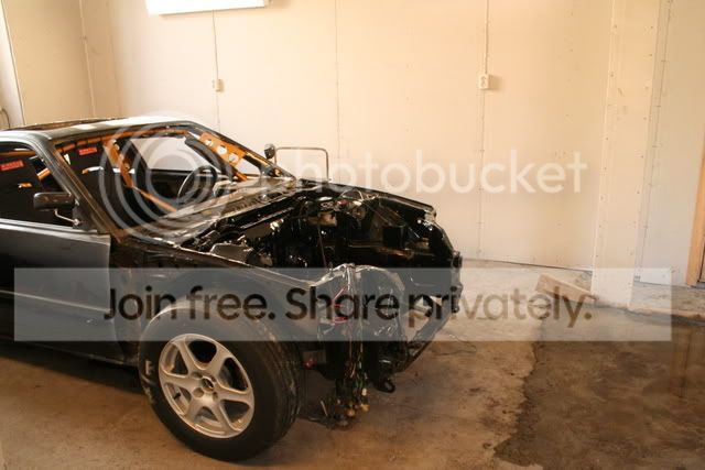

thats a sick CRX.
I like the A-team way more when they are building hondas.
