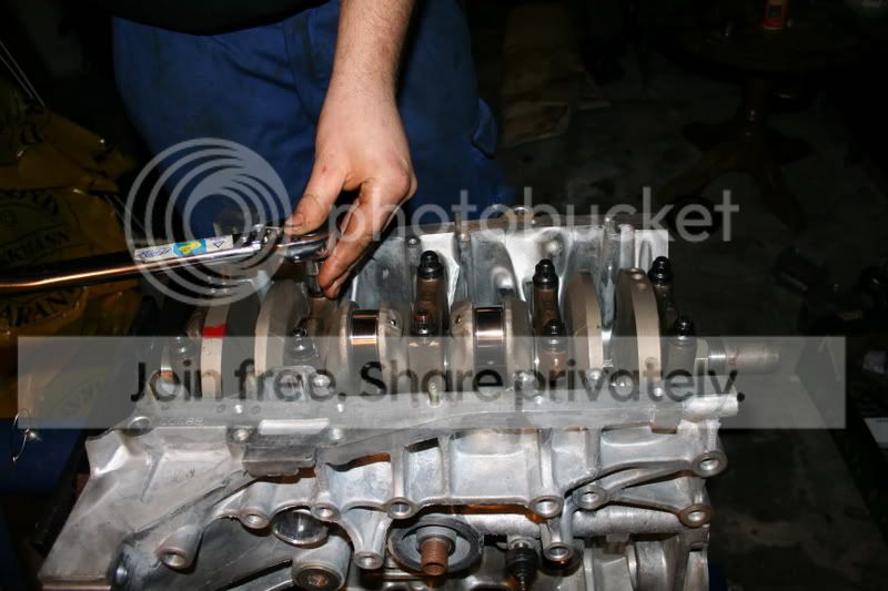

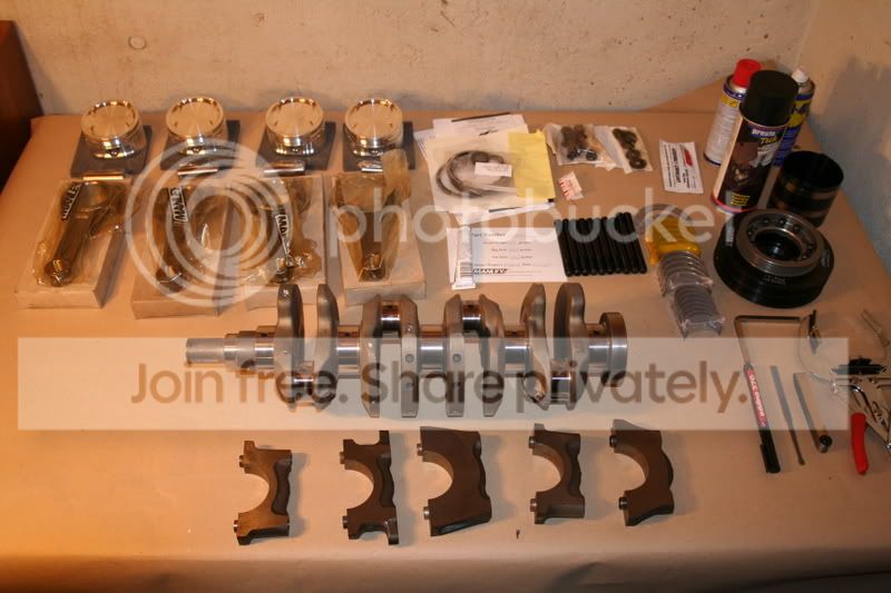

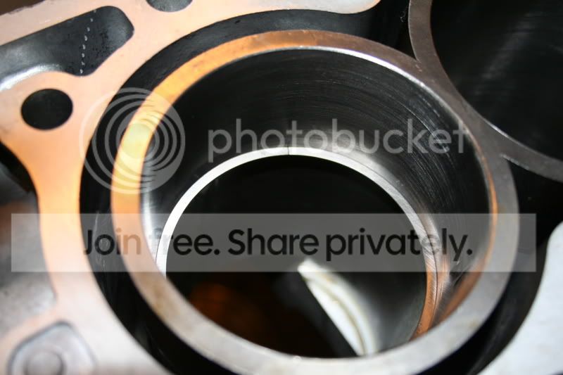

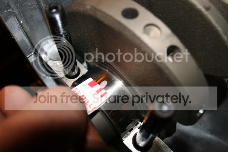

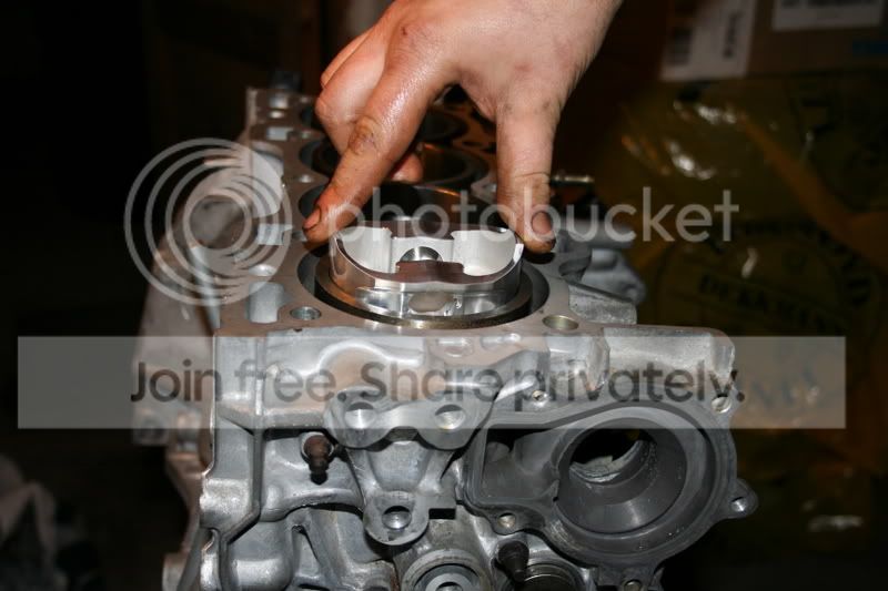

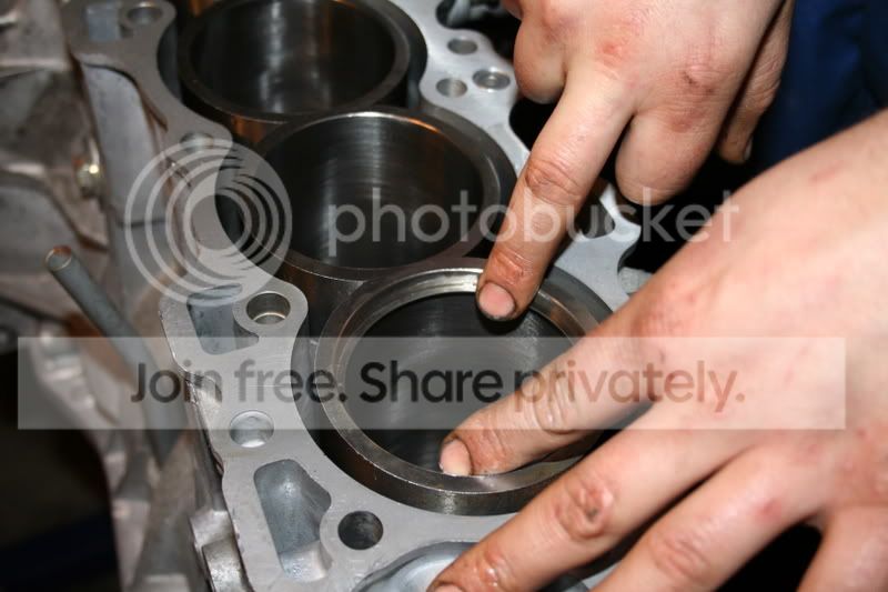

The engine are beeing pre assemblied by now, I just wanted to post up some new picks.
I like to know that all the clearances are correct, if I need to order anything new before I start assembly it.
enjoy:

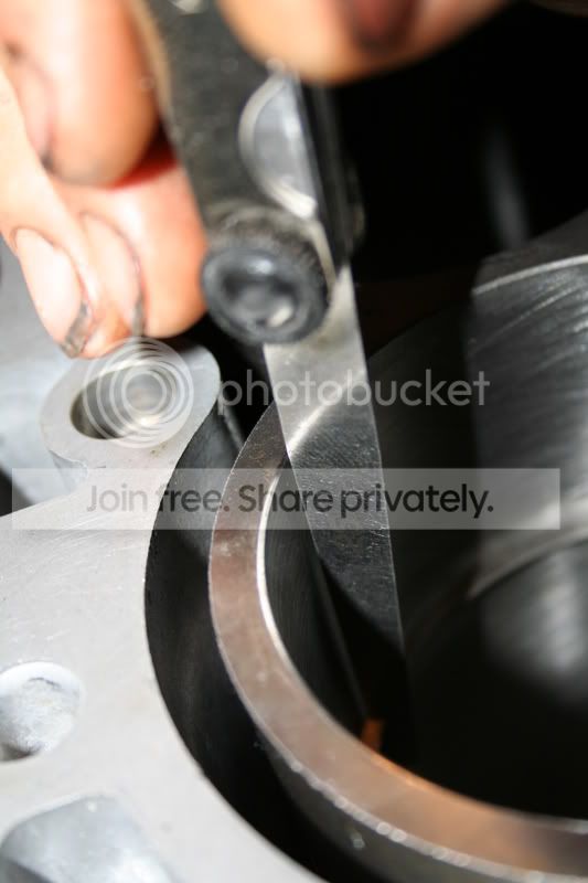

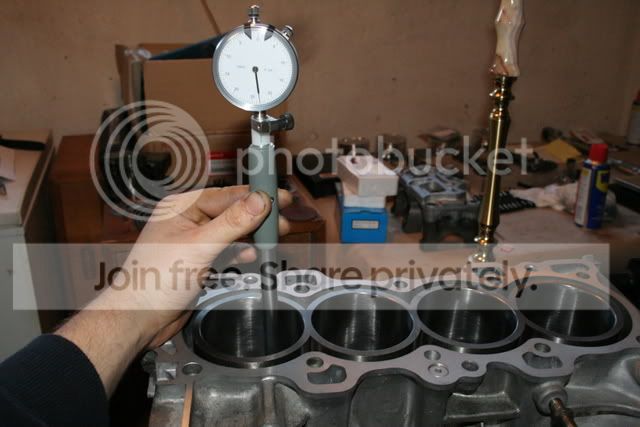

Things are going slow but steady
More pics:

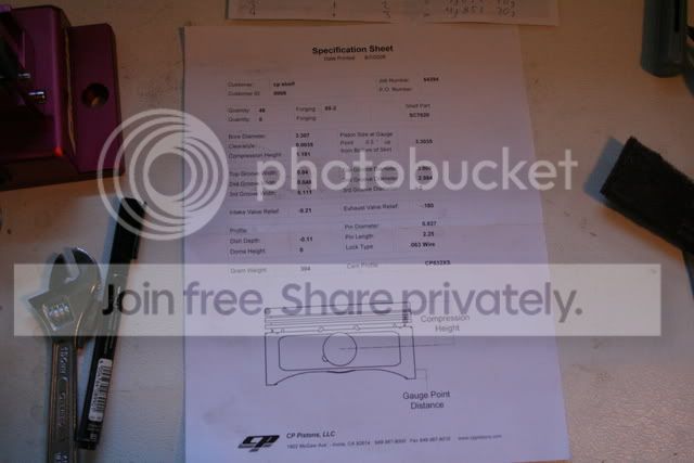

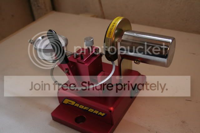

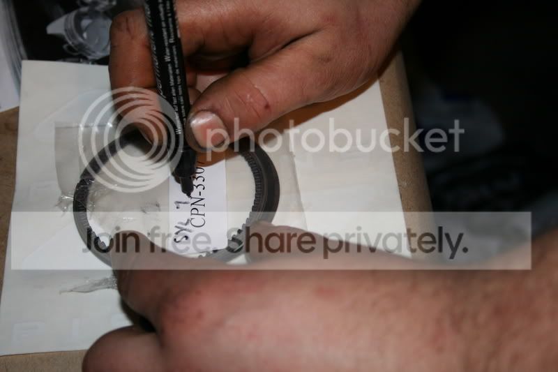

To get the most accurate clearences i choose this type of ringfiler with an indicator gauge, I think it has worked really well for me.
The piston to wall is calculated, and it is too wide, I may coat the skirts here in
Norway to get a bit tighter clearences

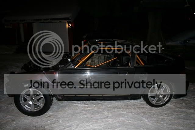

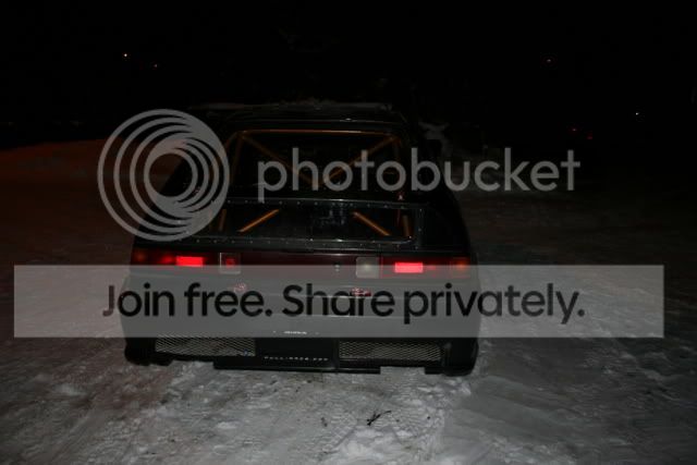

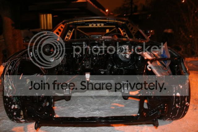

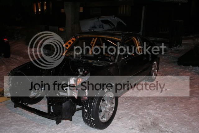

took some pics a while ago, rolled the chassis out in the snow lol
doesnt look wery pretty, but with new paint, a front end, rest of the body and some height adjustments it will be nice. (the seat is just temporary)
here ya go:

Wow you are living my dream with that car, I hope to be in your shoes in the next 5 years, but money is tight nowdays.....Also way was the #4 piston so far off weighting 9 grams off the other pistons?????

9grams? where did you get that number?
The weight diff between the piston/rod combo befor weight matching was about 3-4grams

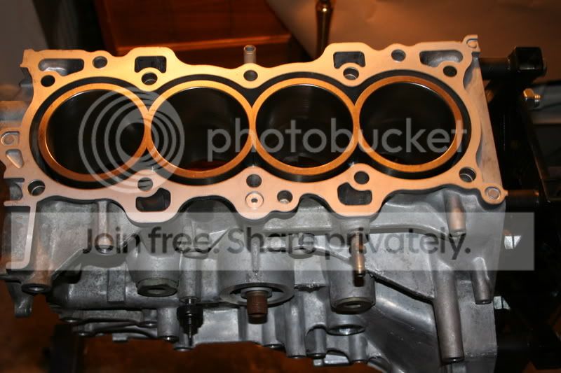

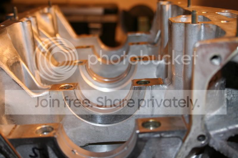

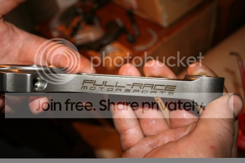

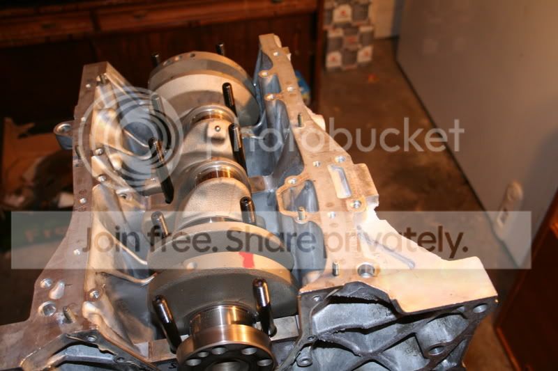

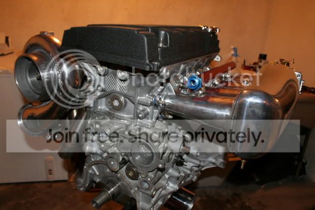

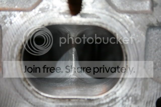

Had to take some more pics, the shortblock is finished, (still loading 3,5mb pics)

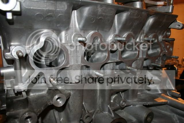

I also had to carry everything down for a "fast assembly" so that i coul take photosnaps of the "slugger"
Picks of the nice work from portflow:
Have to upload, More to come soon...
