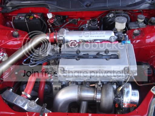

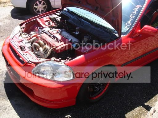

well, i'm not really sure why everyones gettin so pissy over this topic when the original poster just wanted to know how it works. although i've been using mine for 2 seasons, i'm not gonna go out and say everyone should get one just because "I" have one and haven't had any problems. I say if you're tight on cash like i was and needed to replace your radiator, these aren't a bad deal. I can't vouch for the consistany of the quality however cuz I know if they're all good or bad, I've only purchased one. I bought mine when they first came out for $130shipped. I'm sure you can't get them for alot less now. This is also my street car which I drive all the time, although not every single day cuz I have 2 other hondas
and yes, my cap fits like sh*t.
Last years setup with a ram horn and 3" downpipe.
This year's setup with CRP top mount and 4" downpipe. DP barely clears the radiator. David Lee "LEED" tuned my car on a Dyno dynamics dyno and street tuned it for hours. and he'll tell ya, he pushed the car pretty hard. He tuned it at 24psi, I'll be heading back to the dyno here next week to take it a lil higher 29-30psi.
